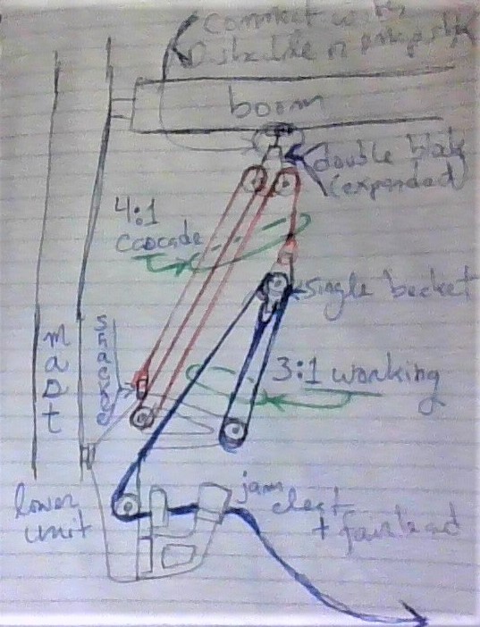

The Blue line is the "working part" that goes thru the cleat, it's 4:1. It uses the double block. The Yellow line is a 3:1 cascade. It uses the single becket. Harken's vang kit includes the "Micro single for attaching the cunningham," in other words to pad their sales. Is why your shouldn't buy kits, but I digress.
Diagram below, literally on back of a napkin, and drawn on my lap. Sorry it's very sloppy :) The fuzzy line is the working part, the single line is the cascade. Yes, you're welcome to share it to r/sail reddit.
Here's how Harken things we should set up a Daysailer, FWIW:
https://www.harken.com/en/support/one-design-deck-layouts/day-sailer/
Cheers!
Harken 12:1 Vang Setup
Harken Vang.jpg (112.29 KiB) Viewed 19018 times

Line for your vang? Either Staset or Bzzline or Robline, something low stretch and not hard to handle (grip in your hand).
The traveler in the Harken DS diagram is a "split-tail bridle," discussed elsewhere on this forum.

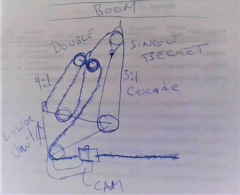

My diagram won't work. I took another look at the lower unit of the Harken Vang kit, the angles on the two pulley wheels closest to the mast are too tight for my proposed setup. Do it the other way around, a 3:1 working part off the back pulley wheel, going to the single becket. Then have that on a 4:1 cascade on the double block, which is attached to the boom, with the line going around the top-front pulley on the lower unit, back to the double block, and tied off to the shackle at the top of the lower unit. I'll draw it up tomorrow, way late here tonight.
Embarrassed to say that what I describe as the correct setup is what's in that Harken promo photo. The red line is the 3:1 working part, the blue is the cascade. They also lead the outhaul line over a block on the top shackle (on the lower unit), so that really makes the photo confusing.
Re: Purpose of the Traveler on a DS1?
Postby tomodda » Mon Feb 14, 2022 11:33 pm
Here we go. Let me know if any questions.
Sorry about the top caption being out of focus ( I was holding my notebook at an angle, I guess). It says that you can connect the double block to the boom eye strap with either a D-Shackle, or a Snap Shackle. I guess you could do a wire pennant as well, with one of those keyhole plates on the boom. Anyway, you want a way to easily detach the vang from the boom, as you have to do that every time you rig the boat. I use a snap shackle myself.
Corrected Vang

Beautiful! Thank you so much. This makes perfect sense now. How do I know how far down the boom to put the attachment? Is it just a couple feet off the gooseneck or so or can I be more exacting?

I'm going to give you a non-answer answer, I always HATE those... You're going to have to rig it up and see where to put the boom attachment, only way to know. Put the lower unit as far down the mast as possible, rig up the two pulleys (working and cascade) and then move it around and see. The exact angle is going to be dictated by the clearance between the two top pulley wheels on the lower unit. You have to pass the working end between the two, going to the lower pulley wheel, so too far forewards and it'll rub against the falls of the cascade, too far aft and it'll rub against the working pulley. Find the happy medium.
For what it's worth, my vang attachment is some 2.5-3 feet aft of the mast, but i have a different setup. Also, as a side note, I'm wondering if that whole Harken setup is strong enough for your DS? It's meant for a Laser. What's the MWL and MBL on the Harken rig? Somewhere in this forum we discussed Vang loads with GreenLake and came up with 800 pounds as a ballpark? I forget, but do double-check your working loads if you haven't already. Vang sheeting upwind puts on considerably more load than just using the Vang for keeping the boom down when running.
