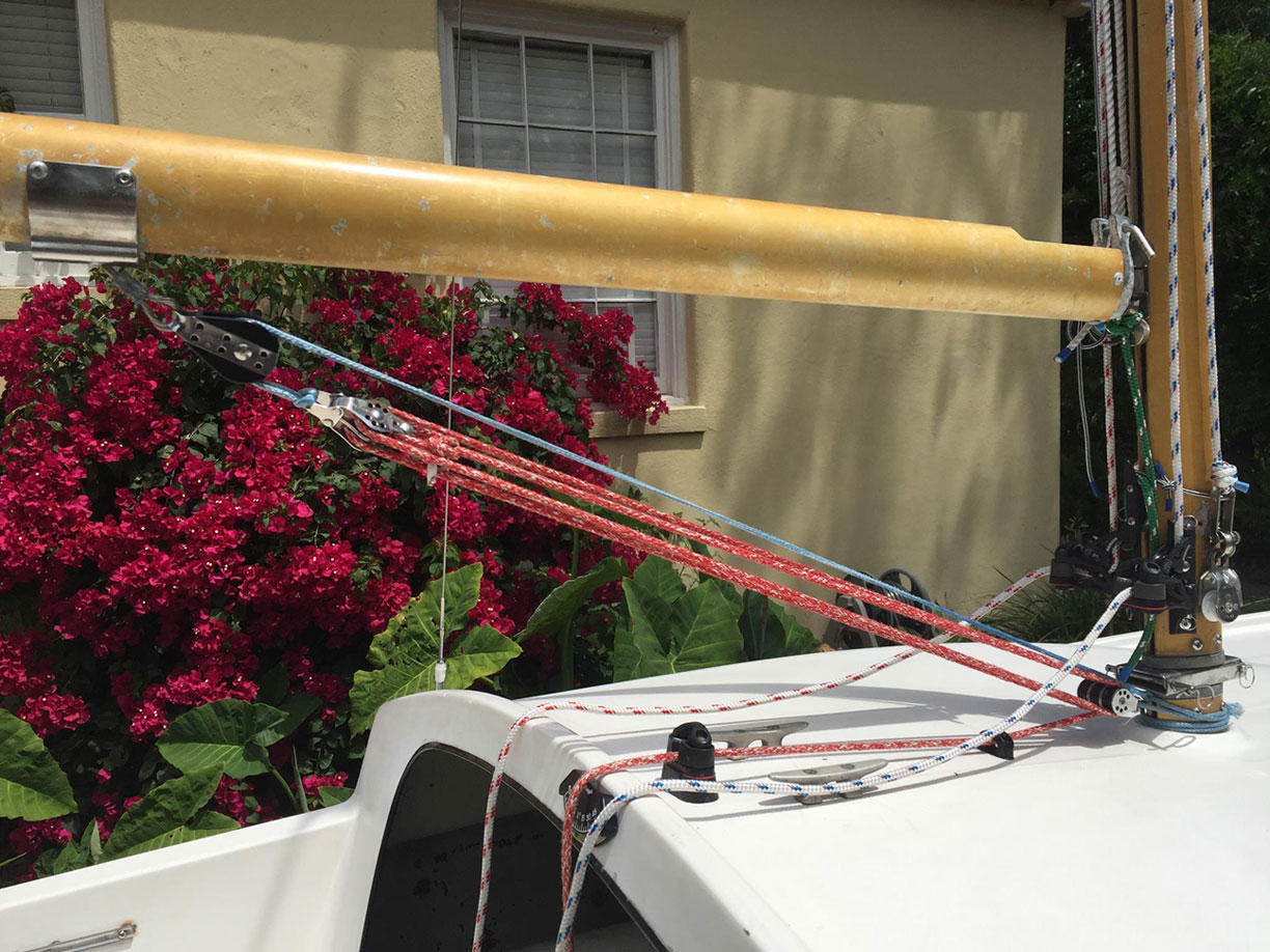

Usually, the number of parts immediately gives the ratio. In the picture there are 4 parts, plus the one you pull on. Because that pull is sideways, it's ignored, and you have 4:1. If you were using this block and tackle to lift something and the last part was pulling up (!), then you would have a 5:1, such a purchase would be termed "rove to advantage" but for that to happen the line you are pulling on must come out of a block that moves with the load (and you must be pulling in line).
Now if you had a 5:1 block and tackle you can use it to pull on the line for a 2:1 purchase. That's a "cascade" and gets you 2:1 times 5:1 or 10:1 mechanical advantage. Repeating that trick gets you to 20:1 or (2 * 2 * 5) : 1. If you can't visualize a cascade, google it quickly.
The big advantage of using cascades is that each just adds a single block. The 5:1 is about the max you can do with multiple blocks, triple in that case, so you take advantage of that. Why doesn't one use 16:1 or 32:1 cascades instead? Well, the downside of a cascade is that the travel (from slack to tight) also goes by the same ratio. Giving up 3/4 of the travel is fine for a vang, but 15/16 or 31/32 - there things begin to look a little different.

As GreenLake posted a cascading 20:1 Boomvang is achieved using a 5:1 Block & Tackle that's doubled with a 2:1 Purchase and then doubled again with another 2:1 Purchase. Want 16:1 then start with a 4:1 Block & Tackle and cascade with a pair of 2:1 Purchases!
Mechanical advantage can be achieved with rope only but the blocks reduce the friction in the system allowing for quick and efficient adjustment which is critical.

That looks pricey. I used a triple and a double block (5:1) cascaded to a single block (10:1), using some dynema rope, and it bends my mast like a bow and arrow.
http://www.harken.com/productdetail.aspx?id=5332&taxid=411
http://www.harken.com/productdetail.aspx?id=5336&taxid=411
http://www.harken.com/productdetail.aspx?id=5629&taxid=411
If that is not enough, add another http://www.harken.com/productdetail.aspx?id=5629&taxid=411 and make it 20:1.
I added a mini cam cleat on a riser and fairlead to cleat the vang off on the top of the cuddy as well (for connivence).
That dingy vang from harken you posted seems like it is going to ride a bit high as well. Not sure what the reduced angle may mean.
There are other issues (annoyances really) that I ran into once changing my vang. Mainly the vang trying to cross up the halyards when tied off to the cuddy roof. I changed my boat so that they terminate on the mast now. These are the parts that fixed that problem http://www.harken.com/productdetail.aspx?id=39802&taxid=416
