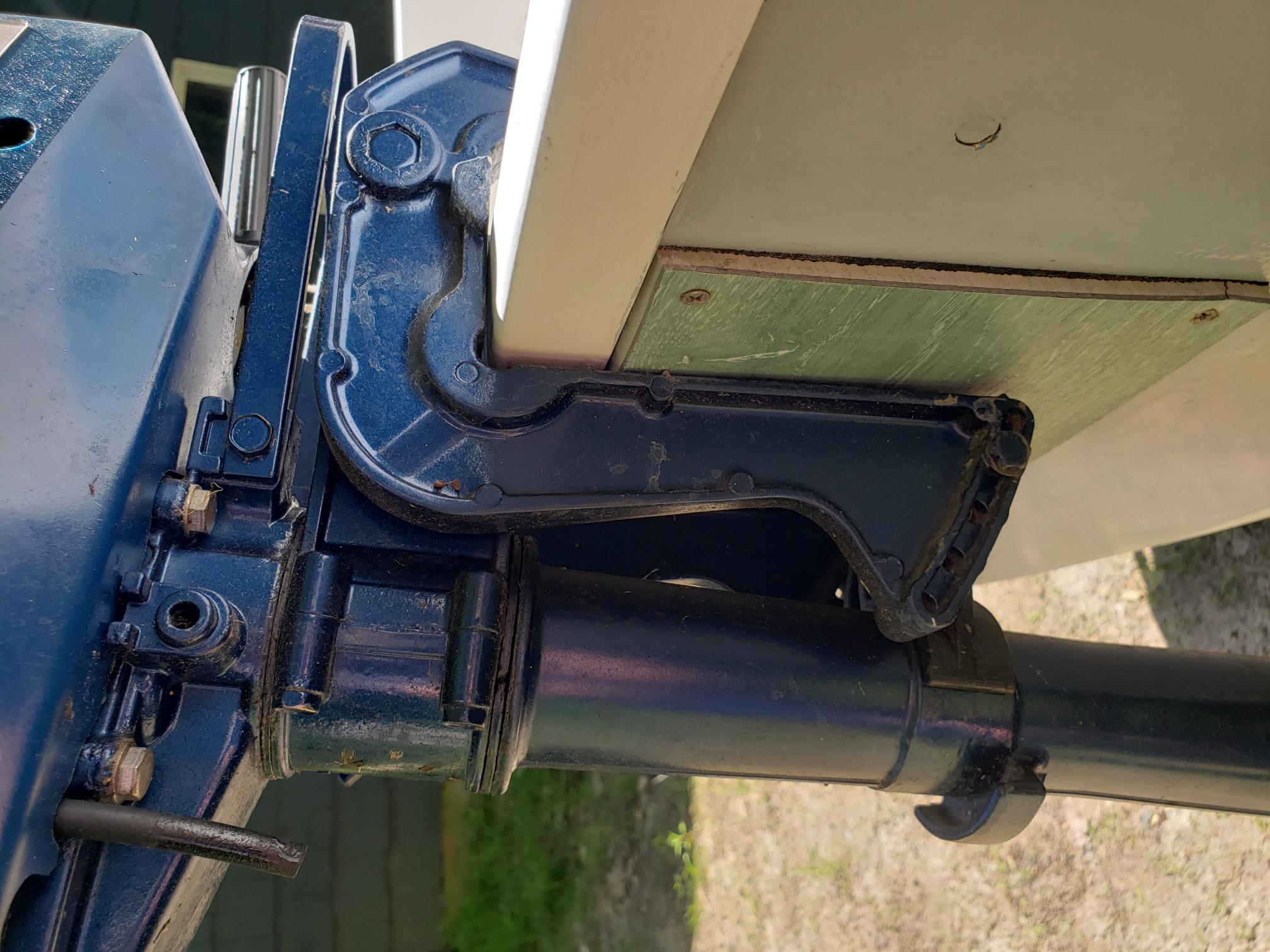

So,
I put the outboard on the back. Downloaded the manual and I can see there's no pin or mechanism to hold it out of the water unlike the manual suggests.
Anyone else have this same issue, or fix ?
And also I have a leak where the filler neck meets the tank..
Anything I can use to seal that ?

Re: Outboard
Postby GreenLake » Sat Jun 01, 2024 6:27 pm
The leak is probably why the motor was on sale.
Not sure you can do anything with that tank material. You may be looking at needing a replacement. (But I'm not an expert).
Does the manual suggest a mechanism with a picture, or specific words? Looks puzzling indeed. Why support tipping if you can't arrest it. Just for when you hit an obstacle?

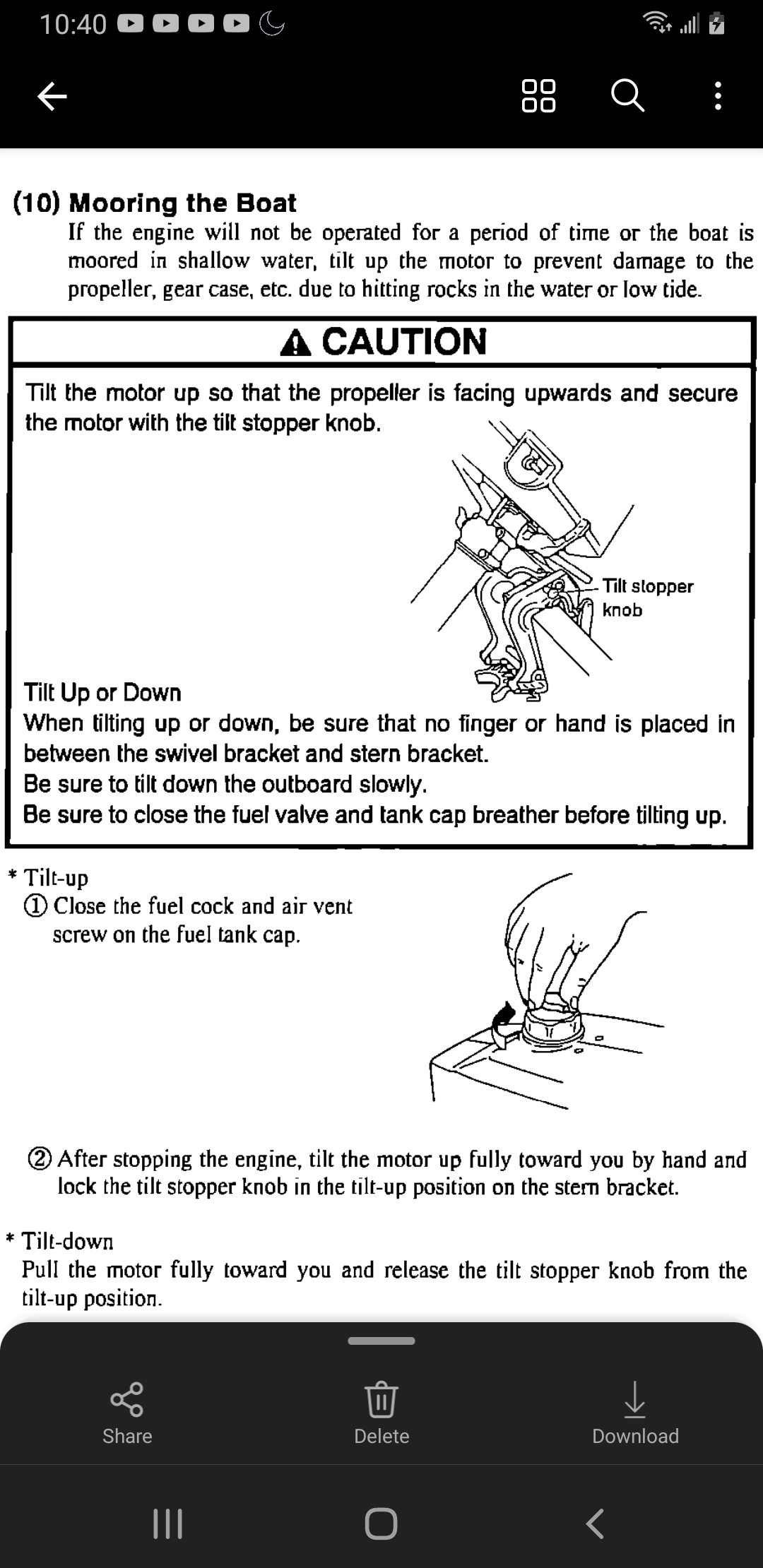

Postby Quiggers73 » Sat Jun 01, 2024 10:43 pm
This is the page from the manual that suggests there is some kind of retaining pin.
But yet there's nothing on the motor casting to even suggest anything would go there.

Re: Outboard
Postby GreenLake » Sun Jun 02, 2024 11:37 pm
Clearly a puzzle.
I trust the side of the bracket not shown in your pictures is the same? Also, there isn't a place that you can hook the blue handle into on the front, by chance?
A simple piece of 2x4 inserted in the gap and with a bungee that you can loop in front would make a serviceable makeshift solution.
It seems puzzling that there wouldn't be something supplied as part of the motor. I do notice that your photo shows a projection right at the transom that looks like something could hook into it. But there's nothing on the motor that looks like it could connect. (Unless there's something on the opposite side).
BTW, one of the reasons why I picked my current E-outboard was the extremely easy way it can be raised and lowered with a simple pull/push on the control rod. (Mine doesn't have a pin either, but it "clicks" into place, which holds it while on the water -- you wouldn't want to trailer it that way, of course).

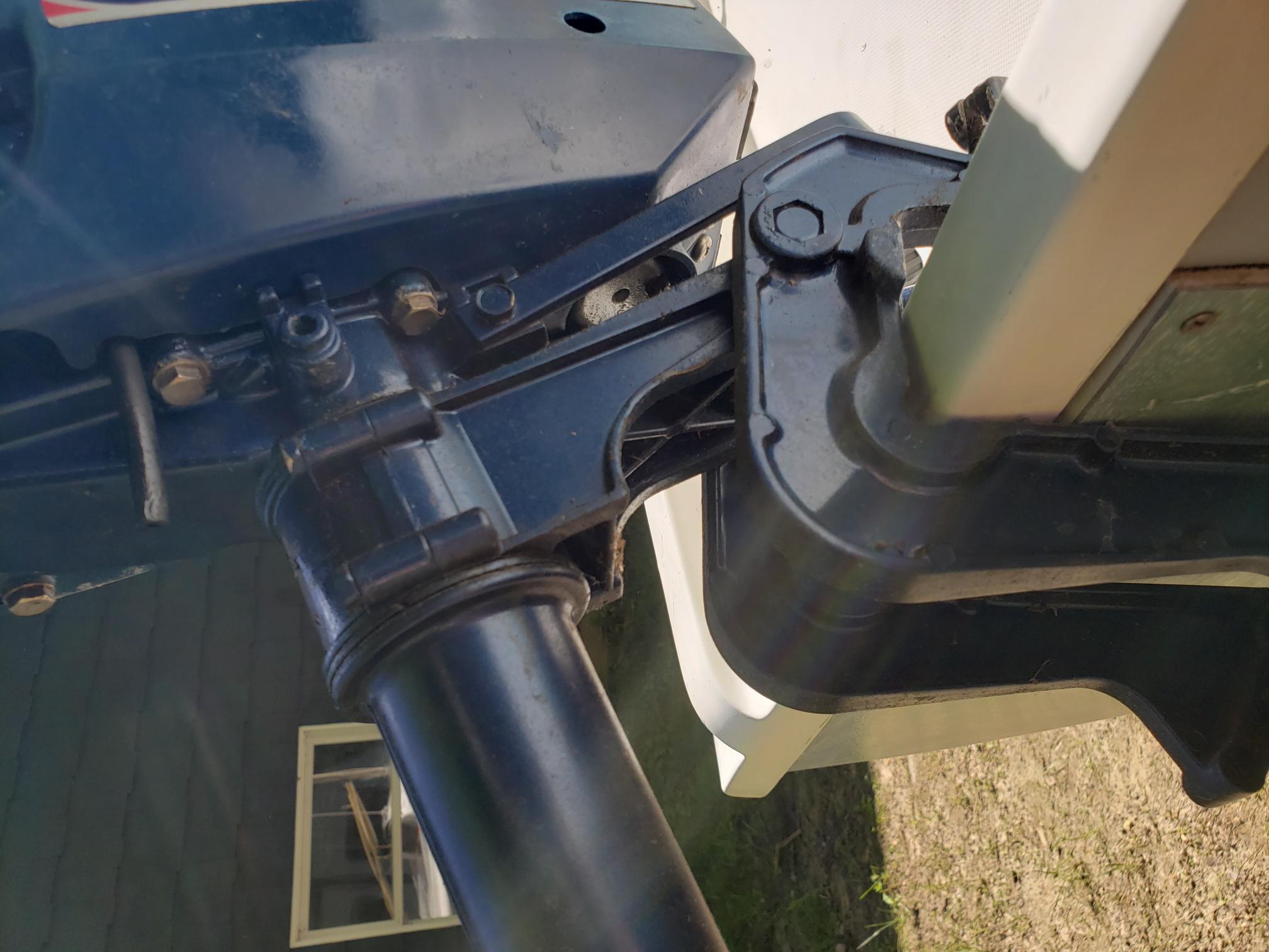

Re: Outboard
Postby Quiggers73 » Mon Jun 03, 2024 7:02 am
Yeah, I've scoured the internet and have seen both versions since.
I checked both sides also, and when I look at the orientation of the bracket from the manual its clearly on the side pictured.
There isn't even a casting where maybe some, were drilled out.
I wondered if ordering the new brackets where the pin casting is included would be worth doing.
For now and maybe the medium term, a piece of 2x4 will suffice, with as you suggest some kind of bungee.
I already have to order and replace the leaking gas tank as it being in the upright position causes fuel to drip down the rear of the motor.
I'd rather not take the chance that whatever I seal that with stops sealing when out and drips onto a hot motor.

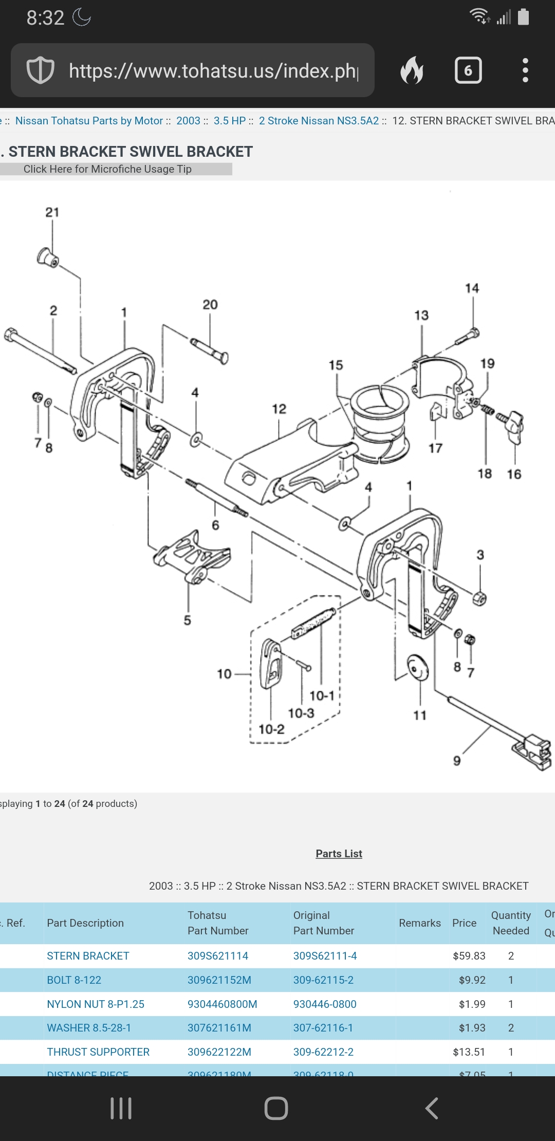

Here's the parts catalogue, clearly showing the casting for the pin.

Re: Outboard
Postby GreenLake » Mon Jun 03, 2024 8:24 pm
Quiggers73 wrote:...
Words of wisdom!
That pin thing is bizzzzzzare.
Not sure what metalworking skills you bring to the table, but any competent machine shop should be able to add a workable custom solution. Might even work better than the factory original. And, as you agree, in the meantime, there's a reasonable jury-rig to see you through.
