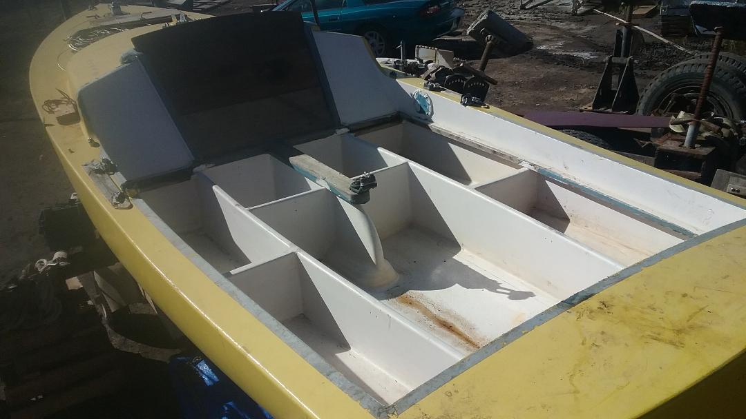

Old Yeller is a U. S. Marine Corps vessel (retired). Beginning in the fifties, she served at U. S. Marine Corps Air Station Kaneohe Bay, Oahu, Hawaii (MCAS Kaneohe Bay) . I reckon this means she is a DS1. She was one of a fleet of Daysailers, used for recreation. Good thing she wasn't there earlier, say Dec 7 1941. That place got strafed, then bombed.
Today I met the guy that modified her. He got her from the guy that picked her up when she retired from the Corps, after the USMC Aviators enjoyed her for decades. No wonder she was tired. To stiffen her, he added the white cockpit "boxes", and the cuddy bulkhead which are all made of foam covered with Knytex Biaxial FG. It worked well.
He also faired the bottom and topsides with microballoons in epoxy resin, for more stiffening, and for perking up her tired soft and saggy old curves. No wonder she feels solid underfoot in the cockpit. I asked if he made a double layered cockpit sole with foam and glass. Nope. Just the original bottom, with fairing added. He said before stiffening she sailed like a floppy wet sponge. Also added a stiffer mast. Performance after stiffening is like night vs day, we are told. Fairing was done by handsanding with longboards. A pro job, he did. Good to know. No wonder she looks so good.
I'm in love.
