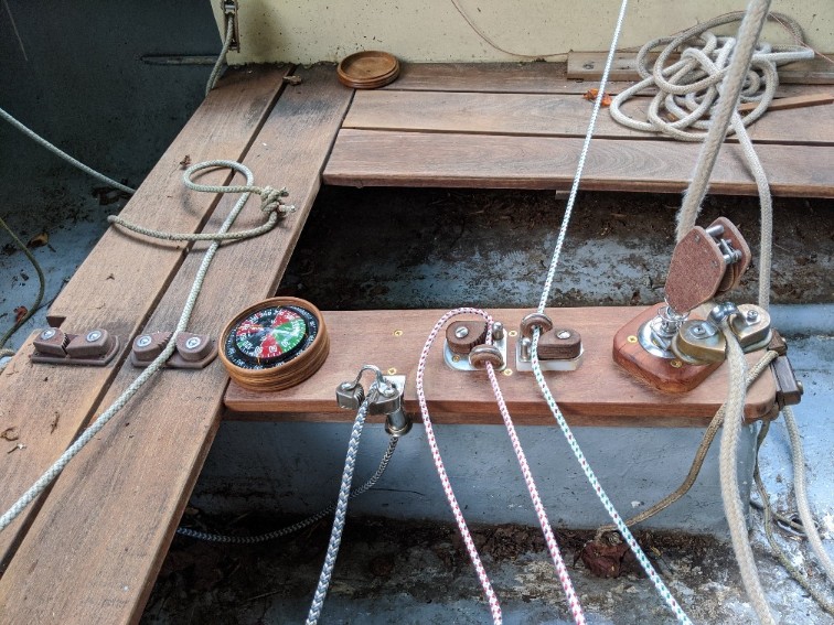

As I wrote up above, the real utility of a compass for us landlocked sailors is to see how well we are progressing upwind. It's an ADI, if you will stand the very loose analogy. Here's mine:

was the wood its mounted on original or did you or the po add it? also curious about all your cleats
Re: compass mount
Postby tomodda » Thu Jan 28, 2021 12:10 am
The wood is not original. I bought her with the original mahogany seats (single piece, not planks), which were mostly rotted out. I used the originals to make a template for my new seats, which are Camaru wood. A tropical hardwood, heavier than mahogany, expensive, but absolutely rot-proof. And pretty, at least when it's oiled. An absolute, iron-clad, B*TCH to work... I had to use a 5hp router to cut out my curves, and even then I needed to go at it with multiple 1/4 inch deep cuts. Was worth it though, at least in my humble opinion :). I still have the original seats and use the non-rotted parts to make various bits and bobs of projects both on the boat and around the house. Nice mahagony, although it's Central American, not the really good stuff from Africa (you can tell cuz it's not as red or dense).
As for all the lines on the CB deck, this was a "test" fit of my new running rigging setup. From fore (the two cleats on the thwart), to aft, they are:
-Jib cleats, Tufnol, no keeper loop, so the jib sheets can be popped off into your hand whenever you need. Note that I tie the ends of the jib sheets together, so they don't get mixed up - this was a GL suggestion, thank you! If the wind is over 7 knots or so, I don't leave the jib sheets in the cleats, they are in my hand.
-Compass. Screwed and glued to the aft plank, slightly overlapping the thwarts, but not attached to them. THis so I can easily disassemble the whole thing, if I need. Like if I need to redo the caulking for the thru-bolts at the top of the CB trunk. I need to do that....
-Swivel cleat and tube for the vang. I got "fancy" and led my vang to the centerboard, so I can adjust it while hiked out. In higer winds and solo sailing, I have jib sheet and vang in one hand, mainsheet and tiller in the other, and I lean out as far as my old body and lazy core muscles will let me... The CB vang is really nice, but a convenience, not a necessity. I'd even say it's a "toy." I'm trying to perfect my upwind vang-sheeting, truly fascinated by the technique ever since I discovered it on this forum. The new vang placement really helps. I don't even want to discuss how much this cost! Several hundred bucks, if you include the tools I had to buy (reuseable, at least) and the fresh marine-grade epoxy. Oh, and I sliced the hell out of my left thumb, adding one more scar to my collection!
-Spinnaker sheets, red for port, green for star. What you don't see are the turning blocks aft and midships to lead the sheets to these cleats. Had to build mounting pads, backing pads, etc. Fun project. I still need to build a better system to hold the guy lines (lazy sheet), for now I'm just "winging it." In other words, I tell my crew to hang on to it by hand.
-Mainsail sheet. OK, this was a vanity project, I had these beautiful bronze camcleats and I wanted to use them. I already had a spare ratchet block, I bought an old swivel base on ebay and machined a part so I could attach the cam cleat to it. Fun project. Essential? No.. I had a perfectly fucntional Ronstan swivel cleat&block before. But this one makes me smile!
-Spinnaker halyard. Hard to see, but it's the camcleat at the back, I led the spinaker halyard to it via a somewhat circuitous path. I got the idea from Phill Root (here: https://daysailer.org/Rigging-Guide). It has a 1:2 reverse purchase, so it pulls the chute up 2' for every 1' pulled. And it's positioned so the helmsman (me!) can pull up the chute while steering standing upright, behind the CB. Best place to be while scooting downwind and trying to get the spin' raised. Let my crew sweat the little details like setting up the spin' pole. In practice, the 1:2 purchase gets the spinnaker up the mast in one big heave, it's great. WHOMP! You've seen the movie Wind, right? If not, go watch it. Silly sailing fun. Break out the Whomper! :D
That's it. I havent' gotten the chance to test the whole system in "real wind", like above 12 knots. But so far it works and it's fun.
P.S. Well it works NOW, first sail had the inevitable breakages, I've fixed them.
