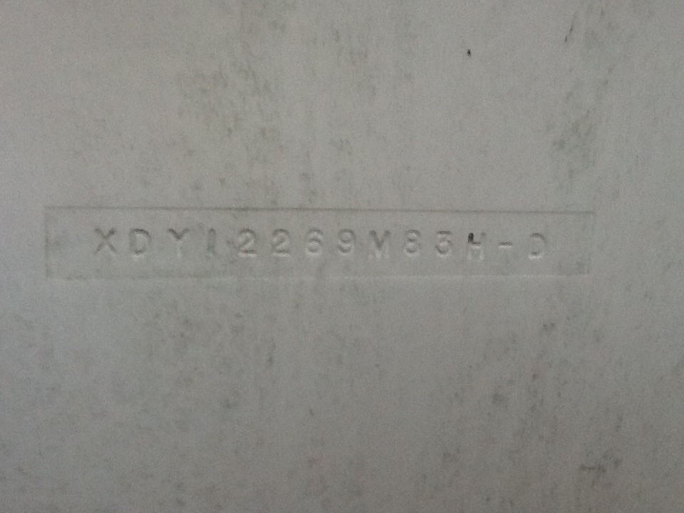

Postby Thomasjbrothersjr » Wed Nov 28, 2012 12:48 am
1983 O'Day Daysailer II
Sail # 12269
Built in March of 1983
