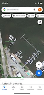

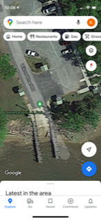

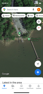

I recently moved and want to sail my DSII from one of to boat ramps. My boat has a 2HP Evinrude outboard motor with a 360 swivel tiller for steering, a throttle control on the front on the motor housing, and no reverse gear.
Prior to the move I sailed from a lake, and approached to boat ramp dock at about 90 degrees using the motor or only the jib. I would have my crew use a boat hook to catch the end of the dock.
I cannot do that at the two boat ramps close by. I must approach the ramp head on, SLOWLY.
Anybody have any suggestions on how to safely do this? I have not used the 360 degree tiller to swivel the motor (to reverse) in order to slow the boat.
My rudder has an up-haul and a down-haul. Should I raise the rudder, or leave it down (with the down-haul loosened from the cleat, so the rudder can kick up if it runs aground)?
I have a tiller tamer, which I have not used. How should I steer, since I can steer with the motor or the rudder?

Postby GreenLake » Tue Sep 21, 2021 1:14 pm
Keith, I tend to sail on/off docks and do better with that, most of the time, than using a motor. The one time I tried one of those motors you mention on a friend's boat, I had the same issues and ended up banging into every boat on the dock. On my own boat I use an electric .3HP (yes 1/7th of yours) that has forward and reverse, but... that's not what you have.
I always use the main rudder and keep the motor fixed. In your case, that would mean that you have a choice of forward or neutral (off). If there's no true "off" position, I would look for a different motor...
Mostly, what people use "reverse" for is to use the motor as a brake. When you sail on/off docks you tend to plan your approach so braking isn't required. However, if you end up with too much momentum, you need a plan B. When under sail, the plan B is a paddle (held fixed in the water, it makes a superb brake).
I'm wondering whether you could benefit from the same approach??
Leave motor fixed, use main tiller/rudder to steer and plan your approach that normally your momentum would just carry you. And, if a bit too fast, use a paddle to serve as brake instead of trying to use a non-existing reverse. But it requires that the motor has a true neutral, so you can cut propulsion.
From your pictures, the magnified boat ramp looks like one I've sailed to occasionally. It's too narrow to approach downwind and do a U-turn at the last moment, but you should be able to approach it upwind, or in a reach (with main down for the latter, and jib sheeted in just enough to get enough momentum). What are typical wind directions or speeds?

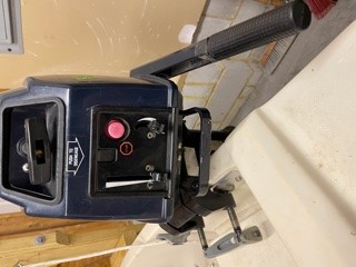

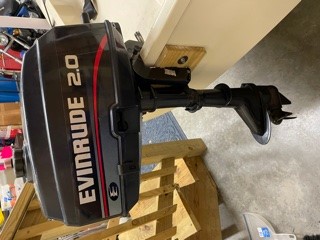

Postby KeithS » Tue Sep 21, 2021 8:02 pm
Thanks for the advise. My outboard motor has a kill push button on the motor housing near the throttle lever. It does not have a neutral.
I don't know the prevailing winds on that part of the James River yet. I have not been out on a boat there yet. The last two evenings have been windy, with winds coming from down river, from the east. The marina next to the bridge is on the south side of the river. The other boat ramp is a about 9 or 10 miles downstream on the northside of the river. The fishing pier is to the east of the boat ramp.
I had best results when I sailed at Lake Chesdin from the dock under sail with the main and jib up, and returning to the dock with the only the jib. I have not thought of using the paddle as a break. The first few times my wife and I sailed, we used two paddles to return to the dock, which didn't work very well.

Postby GreenLake » Tue Sep 21, 2021 8:39 pm
Some (all?) of these motors have a centrifugal clutch. While idling, the propeller doesn't turn. In other words, while there's no lever to select neutral, the centrifugal clutch is supposed to automatically put the motor in neutral when idling. (If that's not the case for yours, that motor would definitely not work).
If motoring is needed, a brief revving up should give you a push and then you can coast in idle on the momentum, not too different from coming in under sail. (I wish I had that technique sorted in my head before my disastrous experience - I've never crashed into every single boat on a dock under sail . . . .).
A single paddle is great for stopping/slowing. It's very controlled, but like the parking brake on a car, it has an upper limit. So don't expect to come in under full sail in 20 knots of wind and expect a single paddle to stop you. But if you are coasting at 2-3 knots and would like to stop the boat to a gentle bump, that's doable.
As to paddling the boat over any distance (a few hundred feet), I found out recently while standing, or possibly kneeling with one leg on the bench beats trying to paddle from a seated position. (You might want to get a SUP paddle, if you need the extra reach.) The reason is that you can put more of your upper body into the stroke, not just your arms, and with the side deck, the taller paddling position gives you a better angle. It should be possible to move the boat with reasonable effort at least the length of on of those docks in your picture.
If a topping lift allows you to take the sail down and keep your cockpit organized for the approach, definitely use it for that purpose. It's a great thing to have in really light winds, when weight of the boom pulls the sail out of shape. I've been meaning to rig one for that purpose for many seasons now, but it's "yet another line". However, if your boat has the setup, what's keeping you?

Postby GreenLake » Thu Sep 23, 2021 10:08 am
The parts diagram for that motor lists a "clutch" near the propeller, but I'm unable to tell how it's supposed to work.

Postby KeithS » Wed Sep 29, 2021 12:58 pm
My wife and I sailed from the marina Sunday. I used the motor to leave the marina and return. The motor does not have a clutch. Returning was a frustrating challenge due to a busy boat ramp, but we made it back safely. I used your suggestion to kill the motor, and coast to a gentle bump at the dock. I approached the pier to port and about 30 degrees to the ramp, shut down the motor, and coasted in to a gentle bump. My wife secured the bow line to the pier, and someone on already on the pier took our stern line. I definitely need a motor with forward, neutral and reverse.
