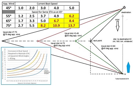

Postby talbot » Mon Dec 22, 2014 3:16 pm
Watching it rain, fretting about pending job proposals, can't even work on the boat, and this is what happens: Escape into pondering tack angles. We all know the boat goes faster if you fall off from close-hauled, but how much faster do you need to go to make it worth the longer tacks? I'm sure this is published someplace, but I put together my own display of how much speed you need to gain in a Day Sailer to keep your arrival time the same for each 10 degrees you fall off from apparent wind angle of 45 degrees. The table at the top of the image is what I plan to cut out and laminate for the boat. The highlighted cells indicate knots well above the DS theoretical hull speed (5.4kt). That is, if you are already going 5kt at 45 degrees into the wind, you would only gain an advantage in falling off if you could get the boat onto a plane. I trust that people will scramble to check my math, and I'll revise as needed. Higher resolution version available on request. Happy holidays!

Interesting subject.
Your math is fine. I checked :) (You might want to put a slightly larger version of the graph with the curves. The legends aren't quite readable. :( )
But you are showing true wind, not apparent wind. Your calculation is based on the course over water (or, in the absence of current) also course over ground. So the angle you are describing is the angle against the wind as measured over the water (or true wind angle).
At different wind vs. boat speeds, the apparent wind angle that corresponds to a true wind of 45° would be different.
The relation between these angles depends on the ratio of the true wind speed to the boat speed. Here's what I calculated.
If the ratio of wind speed to boat speed were constant (for a given wind speed) then we could take this calculation, apply it to your table, and express things in terms of apparent wind (or what we see on the windex). It's not, so, things are a bit trickier. If we had the information (from a velocity prediction program, or from measurements) we would also be able to determine whether it's realistic to achieve the higher boat speeds needed at a larger angle.
For example, if 1.0 knots is the best I can get at 45° TWA for a given wind, is it realistic to get to 1.7 knots at a different point of sail? In other words, is a course of 65° ever realistic? What about 55° at 4.0 kn close hauled?
More generally, can we tell what wind ranges sailing any non-planing angle will get us there faster? These are interesting questions.
Same can be worked out for gybing angles, that is DDW versus reaching.
Using the TWA has the advantage that it can be approximated by compass headings. Not fully because of leeway. Assuming 5° of leeway, one would use your table for headings of 40° to 70° off the direct course to an up-wind target. Perhaps I'll try to measure some actual speed ratios for these angles.

Postby talbot » Tue Dec 23, 2014 12:00 am
Thanks for the clarification of apparent and true wind. That "simplified" article cited by K.C. is something it will take me a while to work through. So glad I don't have to read the unsimplified article.
I didn't put the chart in full size because, as Greenlake and KC pointed out, the continuous functions are really too precise for our needs. In practice, the only change we are likely to make is falling off 10 degrees or less from close hauled (i.e., the first line of the table is the most important one).
I will start next season with the rule of thumb that when my compass shows me falling off 10 degrees from close-hauled, I want to see the GPS pop up 25% (e.g., from 4 to 5 knots). We'll see what happens. The local yacht clubs maintain an Olympic circle of bouys on our lake, which often has the wind out of the north, so I could actually sail a course just like my diagram.

Postby GreenLake » Tue Dec 23, 2014 7:10 am
This discussion is only getting more interesting.
Here's another wrinkle on this: there appears to be penalty in the DS if you point too high, a place where you might think you are still sailing close-hauled but effectively you are almost or already "pinching". The result would be a higher leeway angle, so that while your heading looks optimistic, the course isn't that great and the speed falls off below the optimum as well.
The difference is not 10 degrees, but much less. I'm not sure I've seen differences of a 1/4 of a degree, but 10 degrees is huge. I'm not sure I know how to reliably tell when I am in that condition, the lack of opportunity for comparison with a like boat leaves the GPS as a poor substitute.
For keel boats it's common to have a so called "polar diagram" where you can read off the theoretical best boat speed for each wind angle (at a constant true wind speed). The maximum boat speed upwind is usually at some close hauled angle, with a steep fall off as you "pinch" but before you stall the sails. This curve would be different for each wind speed.
Something like Talbot's calculation could then be used to translate the curve from boat speed to VMG (or effective speed to an upwind destination). The conventional wisdom is that this curve still has its maximum at the close-hauled angle (the same angle where speed through the water is maximized). However, again, you need to draw one curve for each wind speed.
The question is then whether in light or very light winds, for example, it remains the case, that the maximum boat speed and maximum VMG continue to coincide for a displacement hull.
Part of the reason they should is that, especially in light airs, the boat speed contributes so much to the apparent wind speed, and more if you point higher. At the same time, at the relatively low boat speeds you might have the best chance at driving the boat noticeably faster with a correspondingly smaller increase in power (as you get near hull speed, fat chance to get faster at all). Light air racing is definitely different, but there are many other aspects besides pure tacking angle that drive success there. (Where you are and which wind you have trimmed your sail for matters a lot when a puff finally comes -- I remember once being surrounded on all four sides by boats just a few boatlengths away to find myself accelerating and sailing away from them, while they appeared to stand still -- you'd sworn I was using a motor...)

Postby talbot » Tue Dec 23, 2014 3:29 pm
Great discussion. I think the GPS is useful at those marginal transitions (such as trying to sail just a little too high), where the increase in speed from falling off a degree might be apparent to the satellites before you feel it through the cockpit coaming. Yeah, 10 degrees is probably too big in increment. 5 degrees would be more realistic, and is the smallest gradation on my steering compass.
I think my chart might also be a motivator in situations where our boat handling is sub-optimal. For instance, if we are heeling more than 15 degrees close hauled, but can bring the boat down close to 10 degrees (either by steering or hiking), we very well could get the speed increases my chart requires.
I would imagine the easier a boat planes, the more sense it make to fall off. I understand that NZ took the early lead in San Francisco by realizing that foiling at lower tack angles was much faster than having any water contact with the hulls. Oracle had to fall off and beat NZ at its own game to win the cup.

Postby GreenLake » Wed Dec 24, 2014 3:35 am
Talbot. Having played with a GPS for a while now I'm not really convinced that it's more sensitive than telltales.
For one, it only updates the display every so often, and subjectively that seems to me less often than the boat state changes due to wind or waves.
For the other, when sailing upwind, the most relevant thing is the direction of the apparent wind. If that changes due to speed change or wind shift, I'm better off adjusting to that than to an average course. Bethwaite, in his books, discusses how the wind oscillates about a medium direction. Stuart Walker also mentions that in detail in his books on both racing and weather.
Where the GPS (as replacement for a compass) comes in handy is in tracking such shifts, especially when it comes to realizing that a shift is no longer oscillating but that some permanent wind shift has happened. The other place were the GPS comes in handy is in recording a trace of where I sailed (including actual tacking angles over ground). Combined with some direct recollection of how the afternoon's sail went, the trace lets me observe things afterwards, from a bit different perspective. Sometimes it's even possible to see a "wind shift" in the trace (because while I remember sailing a long leg nicely to the telltales, the track shows a kink, for example).
My GPS does not record the speeds it calculates, but there are programs that will do that from the distance over time between track points. Curious fact is that the two do not agree !!
I consistently remember seeing peak speeds on the GPs a few tenth of a knot higher than what is later read off from the track. One factor appears to be that track points are recorded less frequently than each change in the speed value, so that the speeds read off later would be averaged over slightly longer intervals (hence miss the peak speeds).
