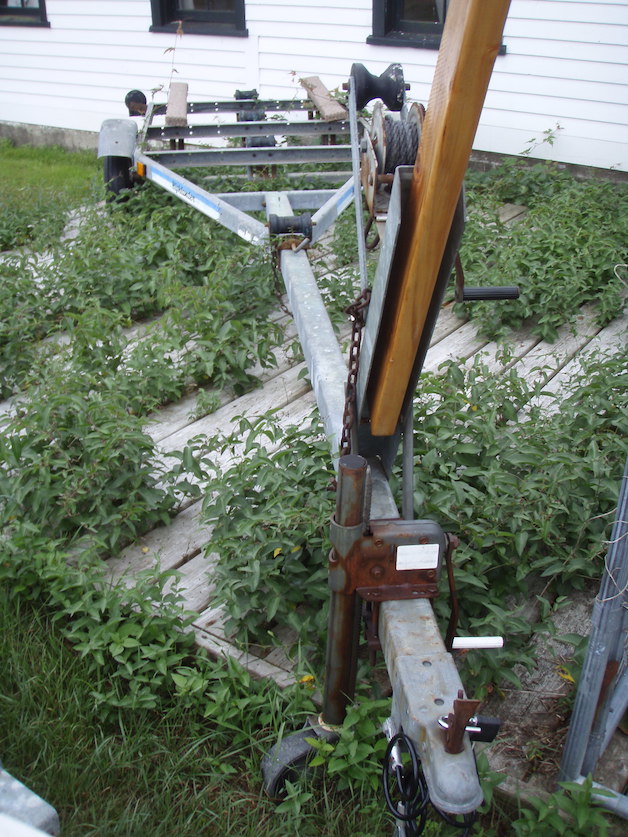

Has anyone posted a video of taking their DS out of the water onto a trailer? I would love to watch ... also dealing with the mast ... down at the ramp while in the water or afterwards when on the trailer. I've had my-new-to-me DSII on a mooring since July and am planning the pull-out ... wanting to be as prepared as possible and be able to tell my helper(s) what to do. I decided against a new thread, thinking that this was good as any. Other trailer posts seem to be all about bunks and rollers. I've now watched several videos online about launching and hauling in a boat at a ramp, but none specific to a daysailer. Trailer is Hylander with tipping mechanism which seems frozen. Ramp is very gradual. Wheelbearings were just replaced and a missing roller also (on the first crosspiece). If there is a relevant post I missed, would love a pointer to it.

We'll see whether this needs to be split, but first let's look at your issue.
I'm not aware of a video, and when I got started, no such thing was available.
The process of retrieving a boat is not very complicated. Your trailer looks pretty much like mine did when I first got it.
Here's what you do.
  • You disconnect the trailer electrics.
  • You back the trailer into the water until the rearmost roller is just submerged.
  • You pull the boat's bow over that roller, straighten it out, and then reel it in (I usually give a big yank to get the boat halfway up the trailer before connecting the winch line).
  • You pull the trailer on land (watch for overhead cables or branches!)
  • You check the alignment of boat on trailer and, if needed push the stern sideways to get it centered.
  • You lower the mast and secure the boat, re-attache the electrics, test the lights and drive off.
I modified my trailer after the first few years to make retrieval easier. If you have enough time, I suggest same, otherwise, do it next season.
I replaced the rearmost roller by a much wider one with a shallow V shape and a "notch" or "groove" in the middle. This one captures the bow more positively and helps align the boat.
I also lowered it an inch or two. This means the rear of the boat is supported by the bunks and not that roller (may want to eventually widen / lengthen the bunks). But it also means that the same bunks start supporting the boat before it is fully out of the water. The good part about that is that a boat that slides will always be pulled towards the winch, while a boat that sits diagonally on a roller will continue to go sideways. If you can, you should lower yours a bit as well.
If the water is warm, a helper in the water can be useful. (I usually manage without, except if there's strong side winds or waves/wakes).
I only use the tilting mechanism on my trailer for launching. If you can't clear yours before the next time you launch your boat, you may have to back the trailer far enough in for the DS to float off. However, floating on is something that works best for trailers that have a lot of lateral guidance, which yours doesn't. If you try this, you may find it a challenge to keep your boat centered. (I have another boat, where the trailer has vertical posts, and floating on is the method of choice for that one; you need to know what works for your boat/trailer combination, that's why watching general videos isn't always helpful).
Does your tow vehicle have 4WD? Can make a difference on some ramps esp. if sandy, but won't help if the ramp is slimy. Be very careful, you can lose your car.
Lowering your mast depends on what kind of mast you have (keel-stepped or tabernacle). Let's take that up separately.

I will look at lowering the rear roller ... but doesn't it need to be above the level of the aftmost crosspiece to keep the bow from hitting that?
On another post someone had attached a photo of a wider yellow roller. I can certainly get a different one there (next year).
Oh, just now found the photo of your trailer with that cool wide aft roller peeking above the last crosspiece. I get it.
