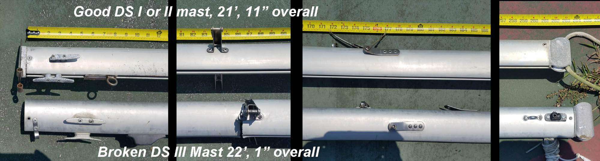

Last week during the tropical storm, my boat blew over in a 70mph gust while strapped both to its trailer and to the ground. Go figure. The mast snapped in two at the spreaders. It pulled cleanly out of the base, shearing the rivets, which remained on the tabernacle. At first I was ready to look for a welder, until I discovered that the mast was bent as well - seems like a goner. As luck would have it, here at the Rehoboth Bay Sailing Association there is a collection of masts from abandoned boats, and in the pile was a mast from an earlier daysailer, either a I or a II. It's two inches shorter than DSIII mast, and the connections for the stays are about 6" lower.
Regarding the stays, I am not sure if I should attempt to make the onesI have shorter (never did THAT before) or move the straps they connect to up on the "new mast" to the identical location as the DSIII mast.
Other than that, I need to rivet on the base to my DSIII to the bottom of the DSI/II mast and I ought to be good to go.
Please see the pic comparing the two masts. Have I missed anything here? Any input is appreciated.
Steve

Postby GreenLake » Mon Aug 10, 2020 9:38 pm
That's a lucky find!
I would suggest you simply call DR Marine and order a new set of stays in the exact length that you need.
Stays should be replaced every once in a while anyway, so why not on this occasion?

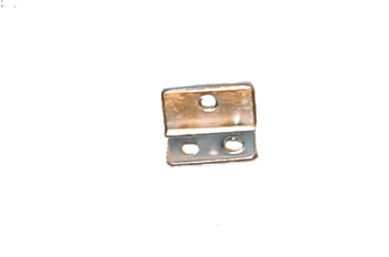

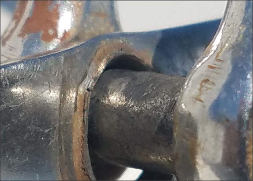

I am considering replacing the two sidestay chainplates with headstay stemheads. As my boat is put in and out of the water with a little crane, and is connected at three points including the two chainplates, I am worries about the chainplates' holding up over time. See the photo of the wear they are incurring. The stemheads, with their two holes for fastening, can be used for the stay and the crane, each connected to it's own hole. I don't think DR sells a backing plate for the stemheads; I would have to fabricate something, probably out of galvanized steel.

Postby GreenLake » Tue Aug 11, 2020 2:47 pm
If the DSIII is like a DSII you could fit a bit of "half-pipe" as backing plate under the hull-deck joint. That's what people did on the DSII to beef up things. Might browse way back in the DSII archives to see that discussion.
