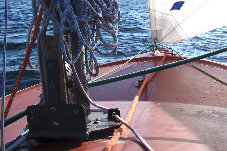

John, I don't have a hinged mast, but I have a "plate" at that location. It's for that hinged sleeve I use in mast-raising. I used to trap the jib sheet between it and the deck a lot. The simple fix was to bend a strip of aluminum to close the gap.
On the picture you can see the hinge and plate. (You can also see the halyards cleated to the mast, with the tails tucked away - the tails are cheap double braid, spliced to Amsteel for the portion that runs up the mast).
The strip I mentioned is visible just in front of the fairlead (it's a bit taller than the plate).
The fairlead is for a spinnaker halyard (that one I do lead to the cockpit, because the spinnaker gets raised and doused under way -- a lot). You can just see the other part of it on the other side of the mast where it leads to the spinnaker (ready for the launch in its plastic tub - not shown).
On the port side of the mast, a similar fairlead for the downhaul (blue/yellow line) is hidden behind the hinge plate. The thin green line is the (starboard) spinnaker sheet leading from the sail around the forestay.
The orange lines are miscellaneous ones (painter and some temporary line rigged just that day, for a long forgotten purpose).
The fat green line is my ludicrously overdimensioned jib sheet (a rope remnant that just had the correct length when I needed it). The thin black/white line on the left is the tail of the reef line. It's thin, but would be strong enough to be used as a halyard.

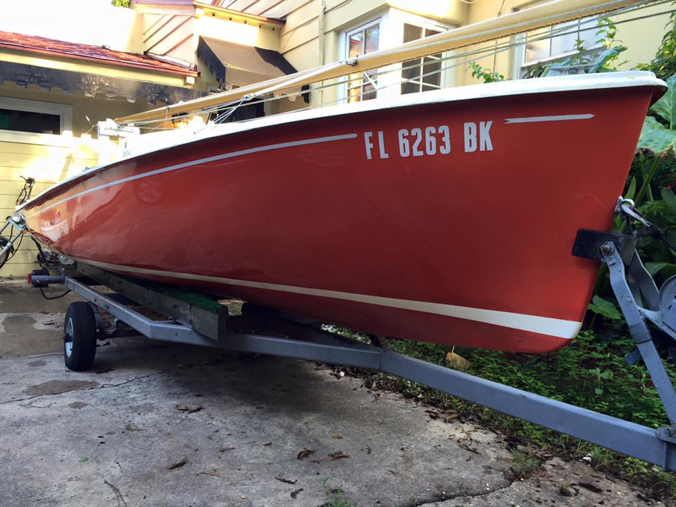

In case anyone is still interested, here is the Hull buffing pics I was trying to add earlier.... Just saying, she was pretty chalky when I got her. That polisher changed a lot ;)
That latter picture is kind of a before/after shot (or really midway).

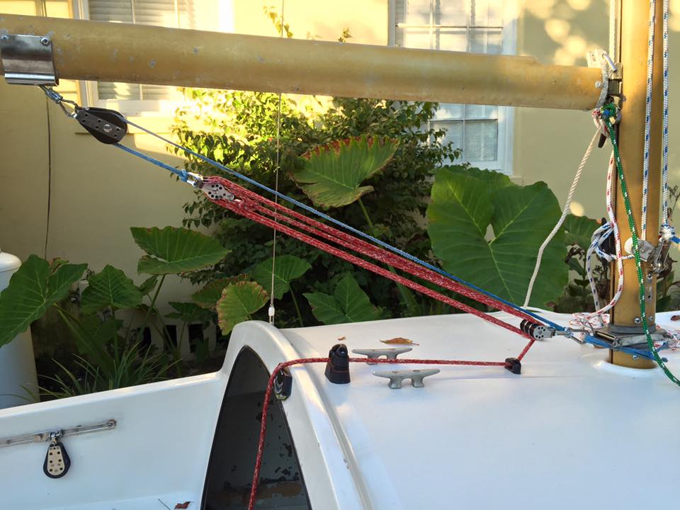

Here is the eyestrap/block deal I was talking about...
You can also see the conflict that is created if the halyards are tied off on the horn cleats on top of the cuddy...

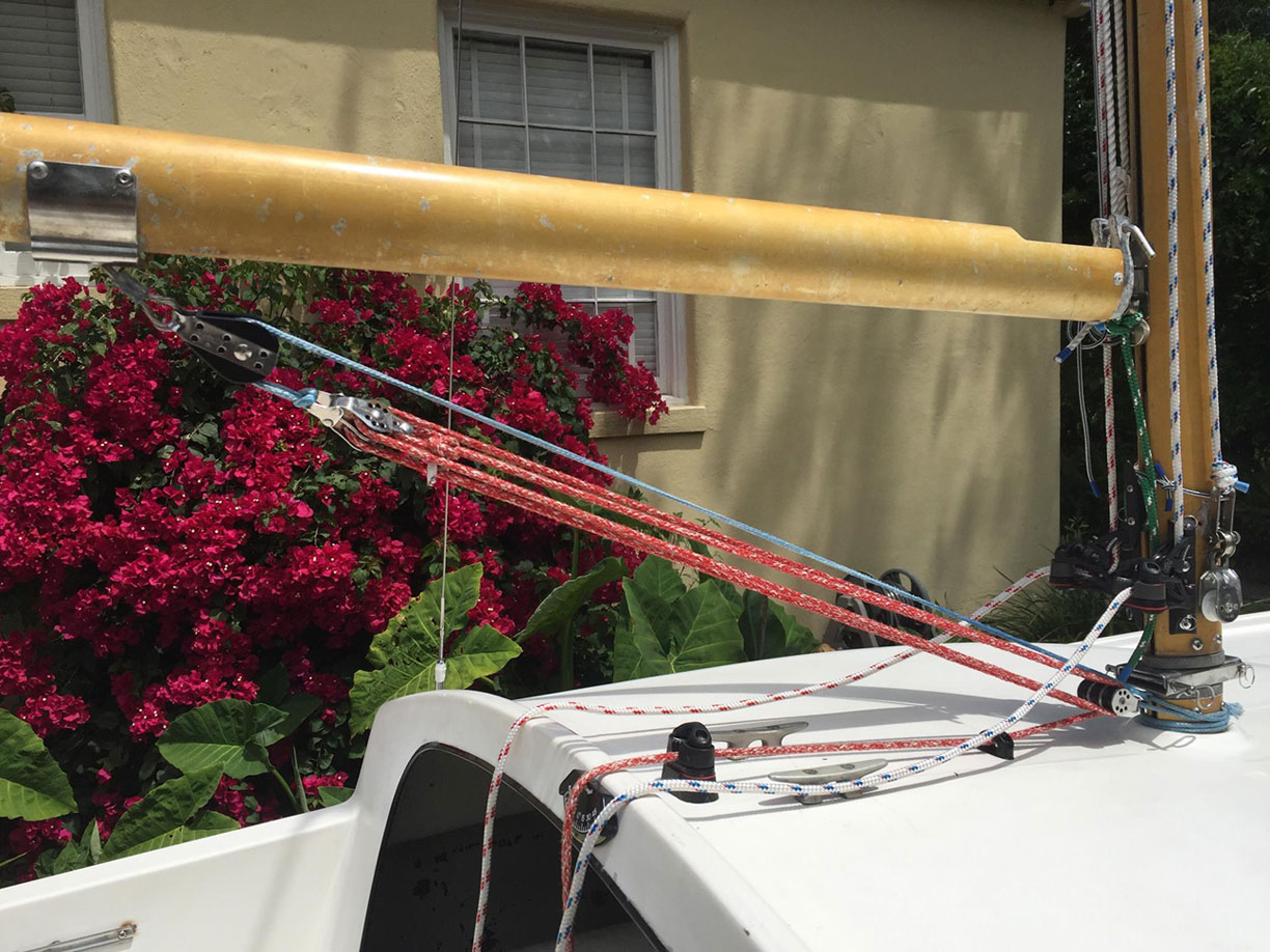

Here is the new deal...
Vang is down, and no conflict with the halyards when the vang moves. Also, if I get rid of the erroneous eye strap/blocks then halyards are pulled aft of the mast enough to eliminate possible snags. The tabernacle pins are the only culprit left. Thus, the little piece of line (black and white) around the mast above the mainsail downhaul cleat (formerly know to me as Cunningham cleat, had to say it, lol), is where I latch the jib downhaul to to create the lift up and over the tabernacle when I tack/gybe.
