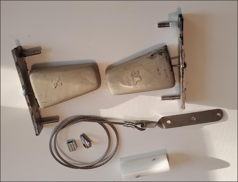

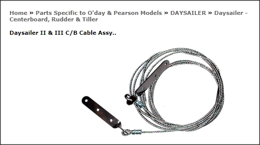

Four months have passed and I am ready to get this thing put back together. I am now tasked with measuring the centerboard to be sure I place and drill the hole where the pivot goes, and placing the connection for the cables to raise and lower the c/b. What's disturbing me at this very moment is that I am not sure I have the entire kit from DRMarine in front of me. Here's their photo of the DS II/III c/b kit, and the collection of parts I have. I only have one metal strap! And interestingly their photo doesn't show the pivot, which was part of the kit. So either I managed to lose a part over the winter or they neglected to include it. Ouch. Anyway, I am off to visit my boat, tip it over and do some measuring.
Regarding the pivot, I believe the best answer to secure it to the c/b is using epoxy or fiberglass resin to glue it in. The c/b pivots on top of the two inserts (in the pics on the table, and in the boat) so there's no reason that I can see for the pivot to rotate INSIDE the c/b.

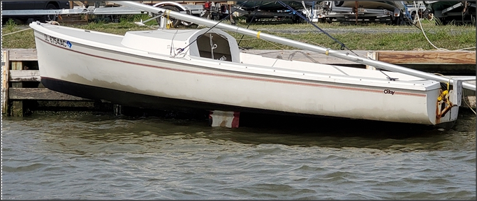

SUCCESS with the install of the donated centerboard (thanks again John). I installed the hardware (the cable assembly from DRMarine and a line for the downhaul) at home. This involved drilling two 1" diameter holes in the DS1 board and filling in the existing square hole. Unnerving but it seems I calculated the correct spots for them. I installed the CB at my sailing assoc using the little crane to tip the boat as usual. I set the metal cable for the uphaul on dry land but put the boat in the water to set and test the downhaul. I lifted the boat out of the water just a bit to confirm that the CB was sitting where it should when the downhaul line was pulled. It was - see the pic!
Though I will be sailing with this CB for a little while, I felt I had to order a new one anyway. This board is "soft" in the center area - you can press down and get about 1/4" or more of "give". It is solid around the edges and near the holes. It ought to hold up until I can replace it but I am concerned it will give out someday if I do not.

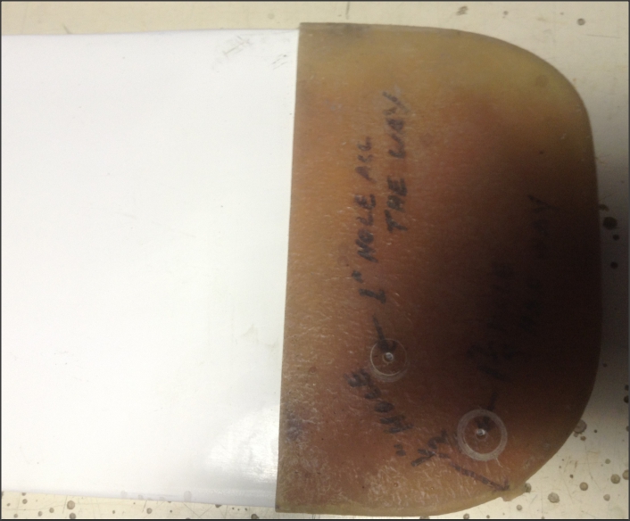

Looking forward to installing that new centerboard. I am going to give the current one a test drive tomorrow though. The new one should be here in a few days. Rudy at DR Marine was able to use an old template, made of fiberglass by O'Day (!), to mark up the board showing where the holes need to go. Fantastic. Here's a picture of the template that he used.
