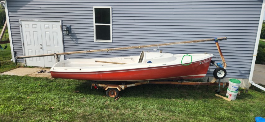

Postby CptnNate » Fri Aug 25, 2023 1:04 pm
The crack is approximately here.
20230806_161740 (Small).jpg (129.48 KiB) Viewed 43412 times
CptnNate
Joined: Thu Jul 27, 2023 10:30 am
Re: Fill this extra hole from the cockpit to the bilge?
Postby GreenLake » Fri Aug 25, 2023 5:20 pm
That looks like it's near the hull/deck joint. My guess is that this makes a simple patch more feasible than if it had been in the middle of the deck.

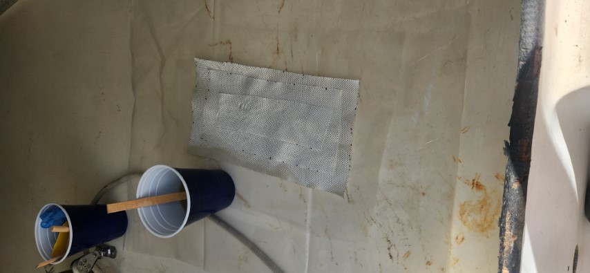

Postby CptnNate » Sat Sep 09, 2023 4:06 pm
BKF worked great on the rust spot.
20230909_134401 (Small).jpg (86.84 KiB) Viewed 43334 times
To repair the crack I sanded down the area and wiped with acetone.
20230909_124324 (Small).jpg (126.4 KiB) Viewed 43334 times
I wet down the area with epoxy, then layed up three layers on some plastic and wet it out before putting it in place.
20230909_131343 (Small).jpg (89.11 KiB) Viewed 43334 times

Postby GreenLake » Sat Sep 09, 2023 4:32 pm
Nice.
Where it's located, I'm surprised that there was a crack to begin with.
However, your repair looks good and you should find out quickly if for some reason that isn't enough. In the new photos, it's easier to see the existing structure and that with your repair it should be quite strong.
