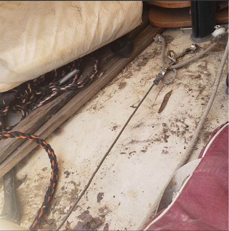

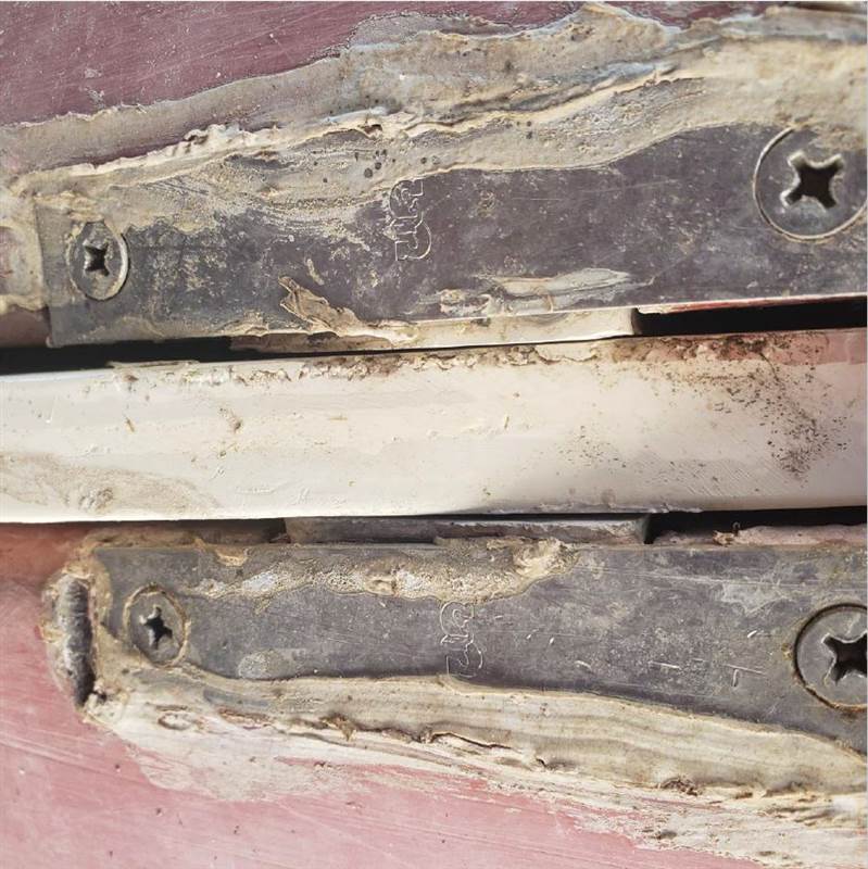

Question 1: My c/b can be manually lifted and lowered from below when on the trailer, but c/b raising pendant (cable coming from front of trunk; Attachment A) will not raise the c/b. When I manually raise the c/b, someone can pull on pendant and cleat the c/b in up position. Also, on the boat bottom at the c/b attachment point is a plate (Attachment B). Should this plate be removed to lower the c/b to expose and repair cable problem? Can removing this plate be done with ease, or will I be causing a new problem? Raising and lowering pendants (rope and cable) seem in good shape.
Question 2: O'Day papers say "As of August 1975, 10 1/2" piece of shock chord added to keep forward pendant tight while c/b down." If I have shock chord would it be obvious in Attachment A? If I do not, do you have a photo of one so I can duplicate?
Question 3: If I need a new pendant system and shock chord, any suggestions on where to buy?

You should be able to remove the pivot plates and be able to pull your CB out. The worst that can happen is that one of the machine screws is stripped and won't come out. (There was a very recent thread on that very issue).
However, assuming that you don't have that particular problem, you can pull your DS on its side (see "Careening") or lift it up, to be able to get at the CB.
The shock cord is designed to makes sure that the pennants are under (some) tension, so that there's no actual slack that can get between trunk and CB. I've sailed on a DSII but don't own one, so I don't keep track of whether this affects only one or both pennants, but anything you rig that keeps tension on the uphaul would be fine.
In your photo I seem to see some rotted shock cord between the eye strap and the block. Whatever you put in, it has to be long enough to not stretch more than the 50% limit for shock cord when the CB is all the way down.
Check where the uphaul exists and from the discussions I've read here, there seems to be a tendency for the uphaul to "saw" into the fiberglass of the opening. That would increase friction to the point that you can't overcome it by pulling on the uphaul. I think that is where the famous "pipe nipple" gets applied by DSII owners to provide protection from further damage and allow smooth raising.
If you don't have any other issues, I would not start with redoing everything. Try some focused fixes on the uphaul and see whether that fixes things. If you later, for any reason, decide to go for a full replacement, don't use factory parts, but use Dyneema (e.g. AmSteel) rope instead. That stuff is as strong as steel at like diameters, does not stretch and is and very slippery. In other words, a perfect replacement for wire. (Works for trailer winches as well, if you still have one that uses wire).

Thank you GreenLake for the site instructions and cb suggestions. You hit the nail on the head: friction in the pendants. I put some spray lubricant on the old cotton pendants as a test and uplift worked. I will now:
1. Replace cotton rope with Dyneema/HMPE.
2. Put in new shock chord per your suggestions.

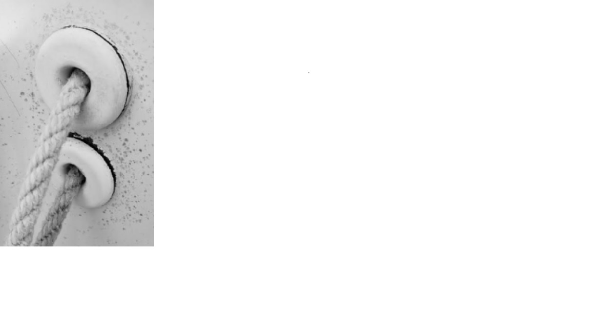

1. In Attached picture "pipe nipple," are the plastic grommets in the photo, already installed at all holes, what you were talking about to prevent "sawing"?
2. I did remove pivot plates (Attachment B; screws were not striped). Should a sealing substance be applied to the plates as in seen in Attachment B? If yes, what substance would you suggest?

AFAIK, there are no hull openings other than the screws under the plate. Instead of sealing around the entire plate, it should be enough to but some sealant around the holes. Here are things I believe I know:
  1. Never use 3M 5200. It's a strong adhesive (read bombproof glue). You don't ever want to use it anywhere you may ever need to take things apart again. Likewise for any of the other adhesive sealants.
  2. Don't use silicone-based sealers (silicone gets into the gelcoat and makes it tough to paint or repair later)
  3. Widely recommended for bedding hardware like this is butyl tape. (claimed advantage is that it stays flexible, so it should be great for applications like this where its held in place between hardware and hull).
  4. Alternatively, a poly-sulfide based caulk could be used. Let it cure first, before fully tightening the screws, so you don't squeeze it out.

Your second question about sawing. I was talking not about the place where the control lines go into the cuddy, but where the wire goes into the CB trunk. You may need to stick your head in the cuddy and look back.
