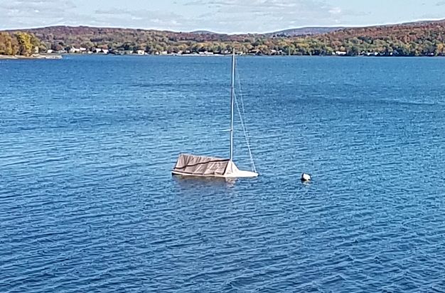

I used a simple approach to the leaking centerboard cable hole, as opposed to the often described tapping and inserting a plumbing nipple etc. I taped the cable to hold it to one side while I filled half of the 360 degree gap with thickened epoxy using my pinky and gloves. Wiped off excess, let dry and repeated for the opposite side. I don't remember if I cleaned with acetone first or put a little neat epoxy (and wait for partial set) as a bonding layer, but both of these would improve the bond. Worked great for me--I think. I say that because I took some more drastic steps in 2 other areas. First, my boat came with no autobailer but just a hole and a plug on the cockpit floor. Not knowing what was going on in there led me to fill the whole thing with thickened epoxy. I had taped the bottom of the hull but maybe could have spent more time with that to keep it flush. Second, I plugged my cockpit drain which was located part way up the transom. I was pretty sure this was not the source of any bilge water but the thing was useless as it was at the wrong height.
I now have only 1 drain in the boat--the bilge drain at the bottom of the outside of the transom. I trailer now, so the boat needs to be covered at home or it fills with rain. I still get a very small amount of water in the bilge when sailing but not enough to care. I sail in pretty bumpy conditions sometimes and find I almost never get more than a splash in the cockpit. Making sure you have functional flotation under the seats and in the bow is key. I used to moor the boat and um it was up to it's gills once. I was able to tow to shore with dinghy, bail with a 5 gallon bucket then hand pump and went sailing. But once was enough. The flotation saved me.

I was really impressed that she didn't sink, especially since I didn't make it to the lake until 4 days later by virtue of a missed call. I think a lot of people have the same flotation under the bench seats--blocks of foam held to pieces of wood with resin. Both of these assemblies are somewhat broken loose from their original attachment points and can get wet by sitting on the bilge floor. Removing them to replace with pool noodles was on my list but the job would involve lots of cutting by reaching through the inspection ports in order to fit the pieces out. So I usually make sure they are propped up somehow when at home or at season's end to let the foam dry. Maybe I'll slide a pool noodle or 2 underneath the assemblies since noodles won't get as soggy as the old foam. But that foam dries out nicely so it's OK. I use nylon screening over the inspection holes with painters tape when drying the bilge. Screened caps would be nice. We get critters in our cars, riding mower engine and snowblower--they love air filters!
The whole episode was a great testament to how seaworthy DS II's really are. I sailed for three hours after emptying the boat and just had a few quarts in the bilge when I hauled out to start repairs.
