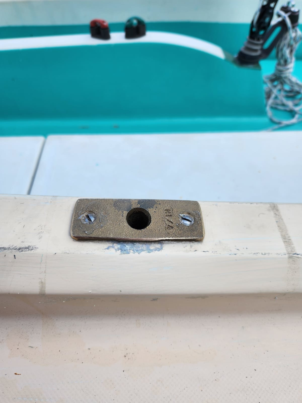

Any obvious reason why I couldn't just mount top mounted oarlock sockets on the top surface of the coaming?

Postby pbobbitt » Sat Jun 03, 2023 6:46 pm
Interestingly, I used a couple of lengths of rope to fabricate a reasonable oarlock to find a pretty reasonable place to position a set of 8' oars. (I built a CLC N.E. dory a few years ago, own an 18' Swampscott and have logged many, many miles rowing)... I certainly wouldn't row it across the Chesapeake, but I'm confident I could pull it a mile or two.
I ended up using surface mounts sourced from Duckworks.
The objective here is to find a way back to the club when the wind is blowing 0-3, not try a novel new entrant in the Blackburn challenge.

Postby pbobbitt » Sat Jun 03, 2023 7:18 pm
Turns out the open space of the cockpit is just over 8' long, so 8' oars fit pretty well on floor of the cockpit... You slide the blade into that little drainage lip between the thwart, and the cockpit floor, they stay out of the way, mostly. I'm thinking if I mount a padeye in the middle of the thwart, I can lash them to the thwart.

Postby pbobbitt » Sun Jun 04, 2023 4:39 pm
So... mostly this was fact-finding, but I managed to row back in 2-5 kt breeze, maybe 400 yards, around an island.
The biggest issues:
1) You gotta pull the rudder or truss it out of the water. It isn't enough to just lash it to the centerline.
2) You gotta work the centerboard to trim the hull to adjust for weight displacement in trimming the hull. Just an inch or two of centerboard (from none) kept the boat from weathervaning into the wind. As the relative wind direction changed, you had to keep trimming the centerboard to keep from having to kill yourself correcting the boat.
If anyone's interested: I started off by just lashing the tiller, then worked my way up to just trussing it out of the water. In the future, I'll just pull the thing as part of the transition from sail to oar.

Postby pbobbitt » Sun Jun 04, 2023 4:41 pm
All in all, i was able to keep full control of the boat in a light breeze. I think I"m going to have to go longer on the oars, and switch oarlocks from horns, to closed circles.
