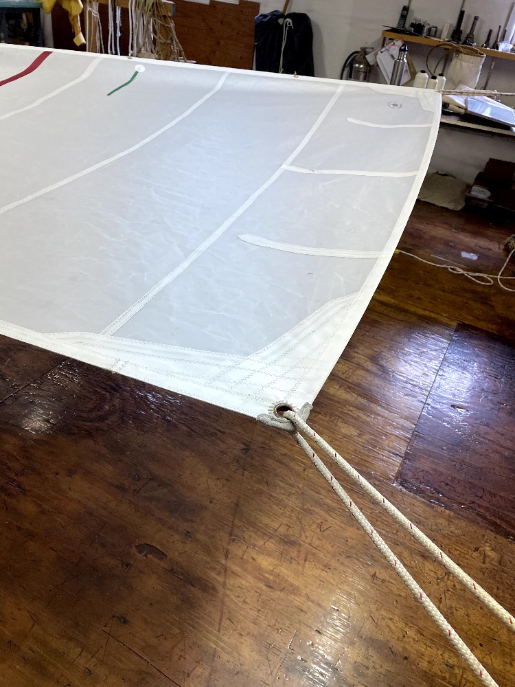

Postby tomodda » Fri Mar 26, 2021 11:42 am
Progress! Sails are done, should ship next week. Thank you for your suggestions, I went over them with Mike, the sailmaker, especially the idea of a single slug along the foot of the main. In the end, decided that the cost/benefit wasn't there for me. After much deliberation, decided to stay with a class-legal attached foot. Nevertheless, to my eye, I wound up with a pretty radical set of sails, very much looking forward to sailing with them.

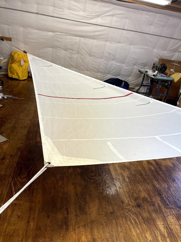

Jib at Loft
Here's the jib, tensioned along the luff. The luff itself is a wire, rather than rope, and the jib can slide along the wire (it's fixed at the head only). And I asked Mike to give me the draft stripe. This all so I can use my jib halyard tensioning system to move the draft around, forward for pointing, back for power and light airs. I like where he set up the draft for "neutral" (how it sits here in the loft) and I'm looking forward to playing with it out on the water. In other news, he put three "darts" along the foot to eliminate fluttering. We'll see how that goes, I'm afraid of the foot somehow "cupping" vertically, but looks OK here:
Jib Foot
I like the leather chafe guards that he's sewn in. The tack and clew rings are also hand-sewn rather than punched in. Nice touches. I like the "old school" triangular re-enforcement patches (rather than the 1/4 ovals people seem to use these days), let's see how they hold out in the long run.

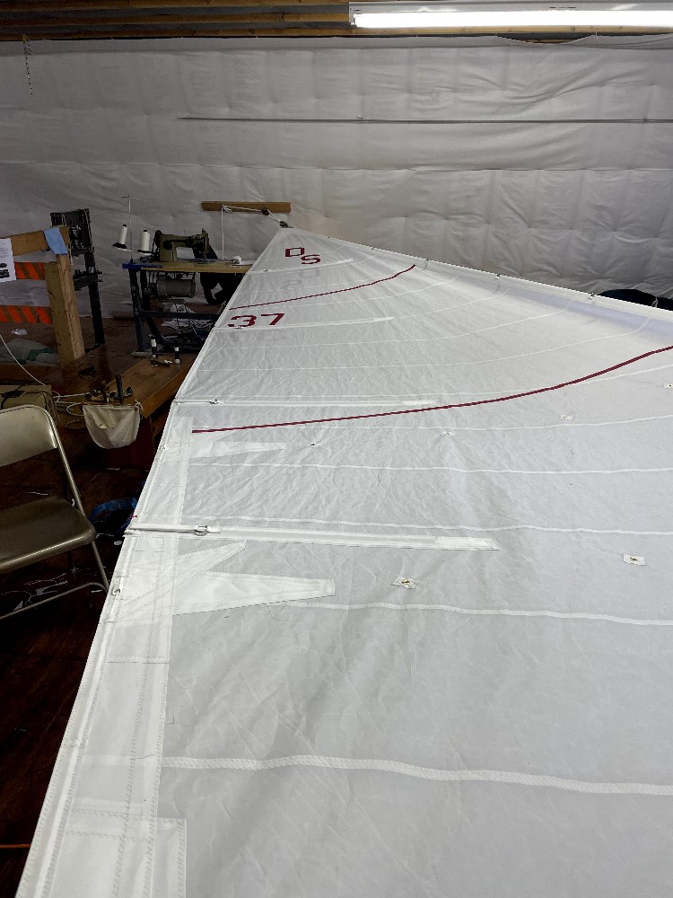

The main sets rather well, I think, look at that nice leech!:
Main at Loft
I had asked Mike to give me as much roach up high as possible, but staying within class rules. This was his solution. I'm surprised that the "break" in the leech-line is at the second batten rather than the third (see the "butterknife" photo at the beginning of this thread), but I'll have to lay this sail out on my lawn to really see what's going on. Again, I like the draft of this sail "in neutral" and hope for a lot of control with my outhaul and main halyard. I didn't expect TWO draft stripes, but rather like it, I can use them to figure out my sail twist. The novel setup that you can't see in this photo is that the sail doesn't have clew rings at the two reef points. Instead there is a low-friction ring on a strap (on the port side of the sail, other side from these photos), a lot like the bigger cruising boats use (reef blocks). This both to cut down on friction and to simplify the rigging of the slab lines. Mike also gave me leech tensioners - although I need to ask him why two? and put extra re-enforcement on the bottom part of the leech. I have no idea how those batten pockets are supposed to work, already sent email to Mike asking. But if any of you are familiar with this type of pocket?
