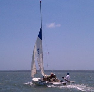

Postby jeadstx » Mon Aug 29, 2016 3:24 am
Rather than designing a whole new rig for the boat, you could just find a used mast the is shorter than the original. Put a hinge on it for easy raising. Put mast tangs and spreader brackets on the shorter mast in the same places as the full length mast would have so that the stays and spreaders are interchangeable with a full length mast. The standard working jib would still work. For the main sail, find a used main that is smaller that would be the same as a reefed main. A reefed main doesn't go all the way to the top of the mast. The boat should then sail like any Day Sailer with a reefed main. The shorter mast will be easier to raise. Keeping the full length mast allows the boat to be easily converted back to original configuration should you want to sell the boat in the future. Altering the whole rig might devalue the boat a lot. Just a thought.
Attached is a picture of my boat sailing with two reefs in the main. You can see how much mast is above where the fore stay and side stays attach.
Reefed Main - 2011.jpg (38.4 KiB) Viewed 35263 times

Postby hnash53 » Mon Aug 29, 2016 2:19 pm
Thanks to all who have posted.
I have my mast hinged just above the deck. That certainly makes it easier to step than having to insert it through the deck to the keel. But even with the hinge, it's still a bit of chore for me to do.
I like the idea of getting a shorter mast and then getting shorter sails to fit the shorter mast. Ideally, a mast about as tall as where the shrouds/stays attach to the standard mast would be about the best route for me to go. I could cut the top off my mast to that point, and then have my sails cut down to that size.
Whadda you think about that? Sure, it renders the boat as a "non-stock" DS2 but perhaps friendlier?
Let me know your thoughts about actually cutting of the top 6-7' of my mast and shortening the sails (or buying a set already the size of a reefed mainsail).

Postby Shagbark » Mon Aug 29, 2016 8:38 pm
I would not cut the mast. There is too much physics going on with balancing all the forces at play. Tim is correct in that by attaching the jib halyard to an eye on the trailer mast support, it will really assist in raising the mast. It pulls the mast straight up the center line while providing a mechanical advantage. Give it a try several times in the safety of your driveway and it will get easier, just takes practice. If you still find it too difficult, either look for a place to keep it in the water or search for a boat that better meets your needs.
