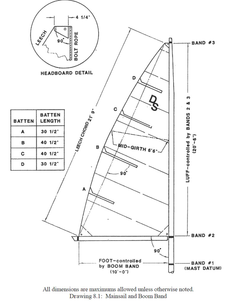

With the two full battens, the sails appear to not be class-legal. That means you cannot use them to race under class rules. If that describes you, then that's not a consideration.

The standard mainsail, by having four partial battens, has positive roach (the leech line at the back of the mainsail makes a convex curve). So its area is a bit larger than what you get from a straight triangle. When you race against another boat, you'd probably notice the difference, but in cruising, you'd mainly notice that the new sails work better than your old ones!

From the class handbook:
8.4. MAINSAIL: Mainsails, when set, shall be attached to the spars using bolt ropes in the slots provided in the spars. Loose footed mainsails and zipper footed mainsails are prohibited. Slugs are permitted on the luff of the mainsail in addition to the bolt rope.
Note, from a racing perspective, sails would be considered "consumables". When you sell your boat to someone intending to race, whether you have old standard sails or old non-standard sails shouldn't matter - to be competitive they'd want to get a new suit of sails sooner or later, all this would mean that if they buy your boat, that purchase would be a bit sooner.

Here's a drawing of the specs from the Handbook:
Mainsail dimension from the class handbook
