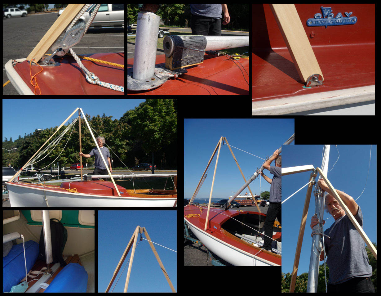

Here are images of the hinged sleeve:
27441545
With this little gizmo, stepping the mast single-handed is really straightforward while standing on the cockpit floor (if you're short, you may need to rig up something to step up on forward of the seats).
If you have back problems, or just don't like manhandling a mast, the A-frame tripod hoist is an alternative addition to the hinged sleeve. It does take a bit more time to set it up and tear down, so I don't use it most of the time, and you may never have a need it. But it is by far the method that requires least strength and agility, and is very safe (the mast can't get away from you).
Mast raising with tripod (open the image in a new tab to see all of it)

PS: the metal disk has come in handy as a place to mount fairleads near the mast base.

Postby GreenLake » Mon Aug 12, 2024 4:06 pm
Sounds great.
I've only ever refurbished/partially rebuilt this hinge, but that was super easy, so I'm assuming that putting one together from scratch shouldn't be that much harder. Not shown in the photos is a plywood backing plate below deck to distribute the load from the fender washers on the six bolts that are used to hold the hinge disk in place. (Two of them also attach the hinge itself)
The big composite image shows the original state of it, the other photos are more recent. I attached several fairleads to the disk which are used for spinnaker downhaul, halyard and jib halyard tensioner. Very convenient to mount all of these onto the disk and not directly on deck.
You can also see that the disk floats a bit above the deck because of the raised mast partners it rests on. After snagging my jib sheets one too many times, I fitted a small aluminum strip to close the gap on the front. Can be glimpsed in the other photos (the two are not taken at the same time, which you can see if you count fairleads ...).
Note the continuous jib sheet with a Prusik knot to connect to the clew.
