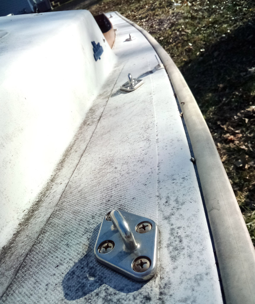

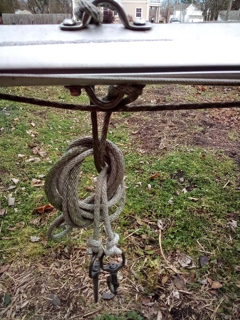

My new to me 1966 DS1 has lower shrouds. The pictures show them and their attachment which is about 8 inches below the spreaders. The other picture shows eyes on the deck two fore and one aft the wire shrouds. The mast is straight 2 1/8" x 2 7/8" not tapered. The steel shrouds are 1/8" and in good shape. The mast also had jumper stays which I have removed after reading much loathing and no defense of them for this boat/mast. I read some discussion of lower stays in the long post titled "#37" where Tom says he would try them before deciding but then the discussion moves on in several other interesting directions without getting back to lower shrouds. So is #37 still equipped with lower shrouds?
Should I keep or remove them? My inclination is always to simplicity and streamlining but I don't want to ditch something a PO thought out and installed for good reasons. Thanks.

Postby tomodda » Fri Feb 18, 2022 4:14 pm
I got rid of mine, along with the jumper stays. Haven't drowned yet.
And are you referring to the same PO who put two bow eyes on your boat? 'Nuff said...

Postby Chincoteague » Fri Feb 18, 2022 10:46 pm
Yes, probably installed by the same previous owner. And I didn't mention all the little pad eyes along hull under the rub rail.
Nuff said, as you say, But I still would love to know what was the intent of the rope shroud retrofit.

Postby tomodda » Sun Feb 20, 2022 11:14 am
Your PO was an "interesting character." I didn't understand before that those glorified clotheslines ARE the lower shrouds. Suspected, but wasn't sure. I'd definitely get them off, post-haste.
PO was trying to set up running back stays, hence the useless snap shackles and the two deck eyes. Upwind, he snapped his shrouds to the fore deck eye, downwind he snapped the windward shroud to the aft deck eye and left the leeward stay at the front deck eye (to clear the boom).Jibing must have been great fun, either a truly hair-raising experience or very slow, Hudson-River style. Anyway, this is all totally unnecessary, 1000's of DSes and other dinghies sail perfectly well upwind and down without backstays! The "secret" is the swept spreaders, as long as the chain plates are abaft the mast and everything is properly tensioned, you have enough fore-aft stability to go downwind. The spreaders "push" the mast forwards, the forestay keeps it from going backwards, all is well. Which brings us to the clotheslines that PO used, there's no way to tension that enough for any real effect on the mast (more than you already have from the wire shrouds). Even if you were able to tension them somehow (most real running back stay rigs use a purchase) and overcome the stretchiness, you'd then either destroy those snapskackles or pull those ridiculously thin eyestraps out of the mast. Also the eyes should be riveted, not screwed to the mast, but at this point it hardly matters.
Previous paragraph just to explain why I write "take those things off now." I'd also like to point out that previous owners didn't necessarily know what they were doing, bless their salty hearts. Remember, the DS was built and sold as the "Volkswagen Bug of the Sea." OK, that wasn't the slogan, but you get the point - Everyman's Sailboat. But not every man (or woman) knows how to properly rig a boat....

PS, betcha the padeyes under the rub rail were for fenders... Your PO really liked belt-and-suspenders solutions!

Postby Chincoteague » Tue Feb 22, 2022 2:38 pm
Agreed on all points and thanks again to both of you for your insights. I hope to spend more than a few afternoon hours on the water and soon I will be looking at all those ways to maximize efficiency. But this season I will be learning with what I have, and at the moment I'm trying to understand just what I do have. Which brings me to the next what-is-it photos.
This one is at mid-mast or about 11 feet above the cuddy. Same vintage I guess - same snaps, same cordage, but forward this time with a ring .

Postby GreenLake » Tue Feb 22, 2022 3:18 pm
You should not wait for next season to fix your mast step.
I"m always for waiting to understand what you have, and to figure out what works or doesn't work for you, before committing to an upgrade, but some stuff is plain "broken". And broken stuff needs to be fixed; that's different from an elective upgrade.
Now a line partway up the mast could be a stupid attempt at a "baby stay" (look that one up) or it could be something used in raising the mast. There's also, somewhere at that height usually an eye to attach a spinnaker pole uphaul. But the strap you have looks overbuilt as if the PO (assuming it's not original) expected significant loads. That would argue for use as a "baby stay". Especially if there's a fitting on the foredeck for it to attach.
Now, if you have a strange sail that looks like a smaller jib, your PO may have used that to "reef" the jib, or to rig the DS with a cutter rig (two jibs).

Postby tomodda » Tue Feb 22, 2022 7:53 pm
@GL: "Baby STAY," no? And the PO may have simply been trying to induce more prebend by pulling forward on center of the mast. Easier/better to do it with a powerful vang, but different times...
@Chincoteague: Anyway, again something I'd remove asap. Use the strap for attaching your vang to the boom, and the line for drying out your socks. :) Question, are you actually on the VA Inside Passage, sailing the Chincoteague Bay? Seems like ideal DS waters (at least in the bay), shallow but good winds.
