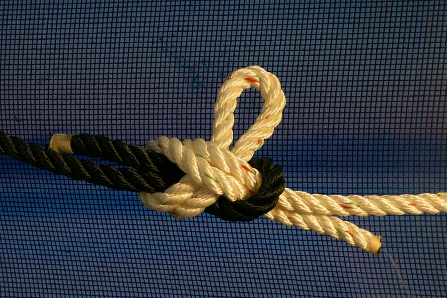

Postby GreenLake » Tue Aug 22, 2017 12:59 pm
Here's my variant of a sheet bend with extra loop.
Sheet bend with extra loop
