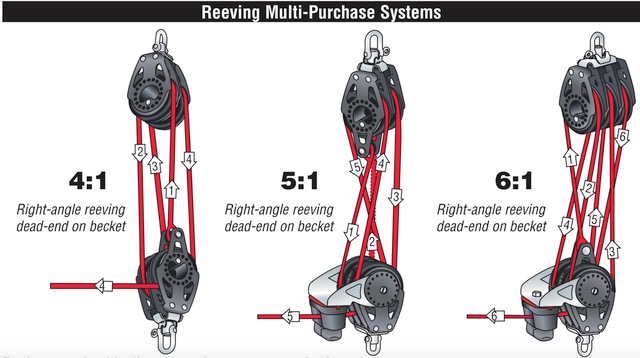

The difference between 12:1 and 10:1 is 20%. Not insignificant, but also not terribly significant. If 10:1 lacks power, the goto move would be a second cascade, so 20:1.
The purchase is defined by the number of parts between the blocks. With two triples that is six parts. As the blocks approach each other by 1", you pull out 6" of line. Now, if the free end exits the moving block and you pull in the direction away from that block, your hand moves another inch, or 7" in that example: you have rigged your purchase to advantage and it is now 7:1.
Including the cascade, mine could be 14:1 if I pulled in line with the vang (instead of simply pulling down). Depending on the exact angle, I could get between 0 and 15% better purchase than the nominal 12:1.
A true 5:1 would need a combo double w/becket +triple w/ cleat, whereas the 6:1 has two triples w/cleat and becket on the same triple.
If you can rotate the cleat (not possible on the Ronstan apparently) then that would be the way to go (and lead the line so it hangs down the cuddy edge). Not as convenient as skipping the cleat at the mast and leading the line to the CB trunk. Am told that I should be playing more with vang setting than I'm currently doing; will see.

GL - thanks for further clarification on 5:1 vs. 6:1.
Re-reading the post the John made I now realize that he does not say if the Harken 29 mm carbo blocks he is using are doubles or triples. I think that I had mistakenly assumed that he was using triples, which is why I asked my question on how he reeved the triples to be 5:1.
I'll wait to hear back from him.

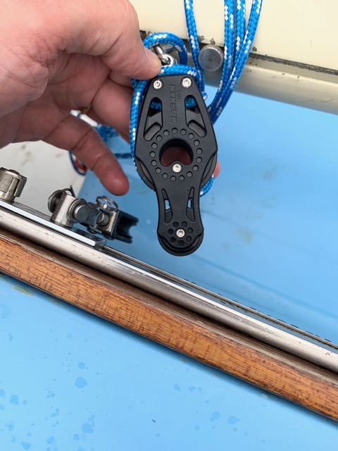

GL and John - when you started talking about vang plates and SS bails / rivets I realized that I had not given any thought on attachment points, nor how strong they are. The SLI DS has SS bails on both the mast and the boom for the vang to attach to, but #2444 is set up differently.
Older Proctor mast and boom, there is a groove in the bottom of the boom, and there is some sort of "track eye slider" (for lack of the proper name) that slides inside the groove. There is a thumb screw and the eye can be moved / slid down the groove. Here is the only picture I have, hopefully enough so you can see what I am talking about.
vang IMG_1942.jpeg (112.39 KiB) Viewed 29665 times
What is this piece of hardware called? I have two others on the boom for the main sheet blocks, as well as one on the mast below the boom for the mast end of the vang. Not sure how strong the groove portion of the boom (or mast) is to handle the working loads we have been talking about for the vang. Should I be thinking of new bails for the vang?

Postby GreenLake » Mon Dec 30, 2019 1:23 am
I doubt the part in the boom can handle horizontal loads from a vang, and while the one in the mas would be loaded more perpendicular, I don't know where to verify safe working loads for these. It's easier to determine those for a U-bail.
