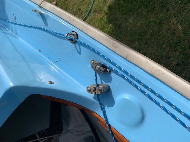

Moving up toward the front of the boat there has been some discussion on the need for forward cleats and blocks for spinnaker sheet & guy lines.
Have looked at several of the DS boats I sail with, at my current SLI DS, and the previously posted 2001 spinnaker rigging drawing and now think that I will add forward cleats and blocks for spinnaker sheet & guy lines.
Something like the picture blow from a friends boat.
GL Instead of a "regular" cheek I have also been looking at the Ronstan 40 Orbit Ratchet cheek blocks you thought would be "interesting", but think it maybe "over kill" (not going to be flying a spinnaker in high winds) so back to a basic cheek block. WDYT?
Going to meet with a sail boat rigger tomorrow and get some of his thoughts as well.

That hook that you show in the photos allows the line to be inserted sideways, I believe; it's not fully explicit in the photos. You definitely don't want a simple eyestrap there.
the cheek block/cleat arrangement is probably fine, or you could put an eyestrap there and hang a ratchet block. Given the space 40mm is probably best. If you don't have a cleat, it's easier to run the spinnaker when single-handing (as you will sit a bit further back and will need to run the sheets back to where you are sitting).
As shown, I would be a bit leery of the spinnaker self-cleating when you want to throw it loose. Something to definitely avoid.

GL - yes not the best of pictures of the hook “fairlead (for lack of a better name) as you need to zoom in to see the black rubber piece on the inside of the hook that keeps the line inside.
I also wondered about proximity of cheek block and cam cleat...
Maybe a 40mm ratchet
Some good thoughts.

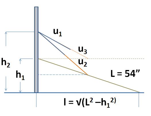

Question for you: About how long is the bungee-cord section for your spinnaker pole uphaul?
Reason that I'm asking is that RWRope, my favorite chandlery here on the east coast, is having a 20% off sale (yay!) for Thanksgiving. So now seems as good a time as any to get the parts to rig my chute. Not that getting bungee cord is a big deal, but they sell UV/abrasion resistant bungee that is better than your average hardware store stuff. I'll buy a double length, just need a rough idea of how much to get. 3 feet? 4 feet?
In the meantime, I'm getting a 2 x (twice the length of the boat) for the sheets/guys, and 20 feet each for the spinnaker halyard and the pole downhaul/foreguy. Does that sound about right? The associated hardware I already have in my "bits and bobs drawer" and I'll put in an order to racelite for anything I'm missing. Although, one last question - why sister clips instead of snap shackles for attaching the sheets to the tack/clew of the chute? Weight/cost or am I missing something?
Thank you in advance,
Re: How to Rig and Fly a Spinnaker
Postby GreenLake » Mon Dec 02, 2019 12:32 am
Last time I purchased replacement cord (and I wish I could get that high quality stuff...) I purchased 15'. I know, because it's sitting right here on my desk, ready to go on to the boat next time I re-rig it. The way I run my setup, the bungee portion is tripled (3/16"). I find that gave me the right tension with the materials I had at hand when I first set up the uphaul. Now, like you, I believe, I purchased a two-year supply . . so the answer would be 2 1/2" per leg (unstretched). The fixed part is 3'.
The long answer is that you can calculate with a bit of elementary geometry (just Pythagoras, no trig), what the longest extension would be on the uphaul (when the pole is touching the deck near the forestay). That's a position that you should need only in a broad reach and in conditions when you need to stretch the luff of the sail to make it set. I believe, bungee cord shouldn't be stretched much beyond 50%. In practice it only approximately works out and there may be a bit more stretch on the bungee than healthy. For that reason, if anything, I'd make the bungee section a tad longer (and then make the fixed section shorter until you get max stretch at that extreme downward position).
I went through all the trouble once of doing the calculations (but didn't keep them). But then, as far as I remember, I decided to simply replace the bungee like for like. But, as I have the extra, I can revisit that decision before I have to commit.
Here's a copy of the sketch I made to work this problem. U(1) is the fixed uphaul, or 3' in my case, U(2) and U(3) are lengths of bungee at different pole positions. They should both be > 2.5' because the uphaul should be able to pull the pole just a bit above horizontal (not shown: U(0) is the unstretched length). U(2) should be the max design stretched length for your bungee. Have fun.
Sketch to show how variable portion of uphaul length changes with pole position. Formulas left to the reader.
Edited: when I replaced the worn-out bungee for the season just now I made the non-stretchable part U(1) quite a bit shorter, and the U(2) a bit longer at 42". The actual length of U(1) works out so that when the uphaul is stored at the mast U(0) (no tension) is just slightly less than the distance h2-h1 leaving a bit of tension. Compared to 30"+30" the bungee doesn't reach or exceed its design stretch maximum (of about 50%) but in dry testing it felt there was enough lift still in the upper range. Will know better at the end of the season.

GL & Tom - above on this thread I think you are both talking about the length of the bungee cord for the uphaul. The Uphaul described seems to be made up of both bungee cord and line.
