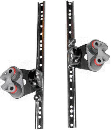

Just off the phone with Rudy at D+R Marine regarding replacement of the jib lead cars on my DSII which are driving me crazy. See attached port and starboard.
He tells me that Ronstan is no longer making the combination lead/cam cars and that he is working with DS customers to design a new product ... hoping it will be up on their website this fall. I said my dream would be a car with a 360° free swivel to which a lead and cam attaches so the sheet can be pulled and cleated when I am solo or with crew and in light or heavy air. He has a lot of would-be customers like me who don't want to have to drill any holes so want something that fits on the existing jib tracks ... in my case (DSII 1983) on insides of the cockpit.

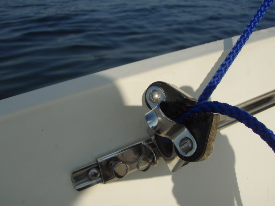

The cars for the Harken Small Boat Jib Lead Track that I had on my boat could be pulled out and opened from the back to remove the block that came with them and then it was easy to install the new blocks. If whatever tracks you get don't have cars that can be opened, it might still be possible to cut away the old blocks leaving a loop to attach the ratchet blocks. That's something that you need to figure out with access to the actual parts.
My mainsheet has a rear traveler, so it goes up, and then back. That 90 degree turn is where I placed my ratchet block for the main:

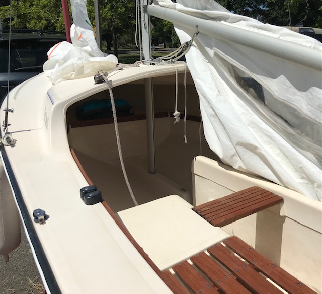

1. I’ve got cleats on top of the cuddy I’ve been using for my jib sheets. I was thinking of installing tracks instead. Thoughts? Would I install them facing up on the side deck or facing in on the inner sidewall/ coaming/ bench back?
2. I’ve got a block and cleat on the side deck I don’t use. What are those for? Is that the alternative option you were talking about GL?

michaelstalone wrote:2. I’ve got a block and cleat on the side deck I don’t use. What are those for?
They look like they might be for a spinnaker. There would be 180 turning blocks near the stern cleats. The sheet would go from the clew to the turning block at the stern, then to the cheek blocks shown in the picture, and cleated as shown.

1. I'm wondering if I should go with the new jib cars Rudy at D&R Marine is now selling on which the swivel (360º ?) is in the plane of the track/seat back instead of perpendicular to it as before (180º). Does anyone have experience with these?
https://www.drmarine.com/proddetail.asp?prod=DS147
D&R Marine's jib cars
2. My vision from the beginning was to keep the combination fairlead/cam cleat, but attach it to the jib track with a free 3-D swivel, keeping the jib tracks in the approximate same position. Has anyone done that? (I prefer not to mount jib lead/cleat on the rail or have a block in the track with cleat on the CB trunk as many have done. And I will not be adding downhaulers or barberhaulers. Trying to keep things simple. I don't race or cruise. Just enjoy going out for an hour or three. :)

Just need to make sure the cleats can follow the direction of the jib sheet as you pull on it. What you show in the picture would work if mounted on top (if I interpret the picture correctly, the pull from the jib sheet for these particular cars has to be in the same plane as the track is mounted on.)
The other side of the jib sheet can enter/exit the fairlead at any angle up to 90 degrees from centerline (in any plane) because of the circular symmetry of the fairlead. (Generally that would mean that the free end of the jib can't be more forward than 90 degrees or the fairlead would rotate so that the angle of entry would become > 90 degrees.
I don't know whether you can get a fairlead/cleat combo that can attach free-floating to an eye strap. Harken makes a small boat track that has cars that have just an eye strap and those would allow you to mount such a fairlead/cleat combo. Except they don't sell such a combo, so you would have to get the track / car from them, and source the combo elsewhere.

To wrap this one up, as GL pointed out, the new cars and tracks from D&R are for deck mounting on a DSIII. Not appropriate for side mounting on the seatback of a DSII. :(
As I've written elsewhere, I'm going to replace my broken track with one just like it ($12 from D&R) with a G10 backplate and use the base of the jib car to attach a Ronstan swivel block with cam cleat. Today's task is to choose which.
