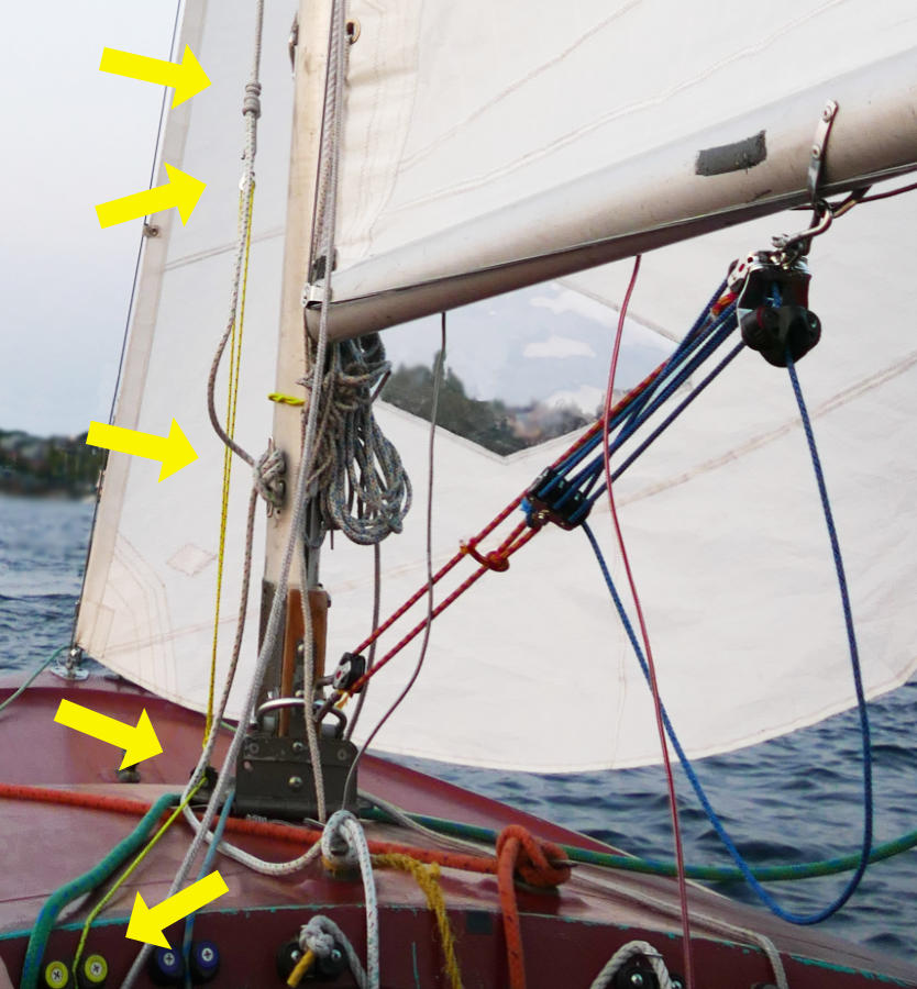

Postby GreenLake » Fri Oct 04, 2024 1:44 am
Looks like I never added a photo of my setup to this thread. I've had one in my gallery for while, so here it is:
2679
This photo shows one of the earliest realizations of this; the biggest change I made was to use a line of a different color to be able to color-coordinate it with the cleat on the cuddy edge. In this early incarnation the jib halyard tensioner uses a blue line.
The position of the fairlead was dictated by the metal plate to which it is attached. All things being equal a position closer to the mast would have been better.
Re: Jib halyard tensioner
Postby GreenLake » Fri Oct 04, 2024 2:16 am
Here's another image showing a more recent incarnation. I've added arrows to indicate in order from top to bottom the location of the Prusik knot, the block and hook, the horn cleat onto which the halyard is belayed, the fairlead and the cam cleat for the tensioner.
2:1 jib halyard tensioner
The green line is the jib sheet and the orange line is the painter (dock line) temporarily secured to a free horn cleat.
(Also shown is the boom vang)
