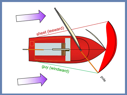

Re: How to Fly a Spinnaker (Diagram)
Postby GreenLake » Sat May 18, 2024 8:37 pm
Here are some diagram I drew for the benefit of a new crew. They are schematic and represent my setup, and not necessarily an ideal setup.
Downwind:
Running Downwind Under Spinnaker
Notes:
  • The wind is not shown from directly aft to be able to distinguish a windward and leeward side.
  • Mainsheet and jibsheets are not shown to reduce clutter.

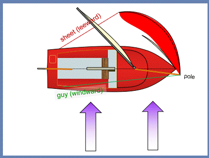

Broad Reach:
Broad Reaching Under Spinnaker
Notes:
  • The apparent wind is from the side.
  • The pole is forward and low. The Spinnaker acts almost like another headsail.
  • The main may be trimmed a bit further back than when running.
  • The jib may be out of the shadow of the main enough to be trimmed.
