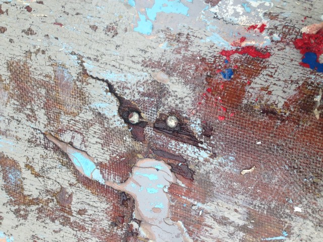

There are a couple spots like this where the wood is clearly showing on the floor of the cockpit. This is the only one that has nails(?) in it, some kind of repair I assume?
So now I'm wondering if I've really bitten off more than (I want to) chew right now. I would still prefer to continue with the stripping for the deck/cockpit and then repaint those for this season, and then come back to these problem parts in the winter to do more in-depth repairs. Is it okay to just let all this dry and then repaint it for now?

You could either do nothing, on the theory that a few months may not make those problem spots much worse, or if you are worried that you''ve opened up ways for water to seep deeper into the structure, you could slap some house paint over it in an attempt to give a bit of a seal. Something easy to remove when you are getting ready to dig out these problem spots.
I believe you have a double hull, or at least a separate cockpit floor, and the wood could be a support (your closeups don't allow identification of where in the boat you found this). Looks like you may need to open up that floor and have a good look and close it up again after repairs. (Requires laminating a flat sheet on your workbench and then gluing that in over the opening (which hopefully goes back to solid laminate on the sides). No way to do wet-layup in place unless you have support underneath.).

Here's where that open wood spot was in floor:
further (Small).JPG (109.9 KiB) Viewed 1164650 times
There's one with the two nails at the top of that stretch of exposed fiberglass and another to the right of it by the centerboard.

Postby GreenLake » Mon Jul 22, 2019 8:07 pm
I think you are overthinking it with the different colors :) Just use a marker . . .
Looks like this may be a "bulkhead" underneath your cockpit sole. Possibly intended to give lateral support to the CB as well as vertical support to the sole.
The DS had "thwarts" that connected seats to CB trunk for the same purpose.
