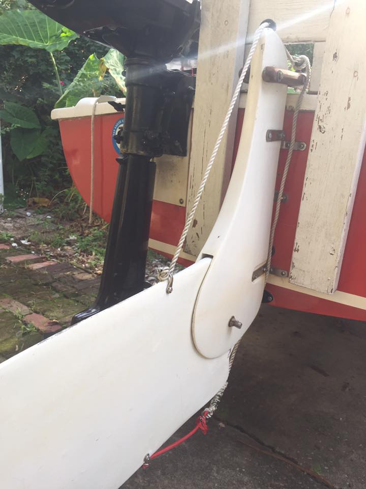

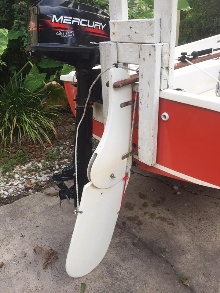

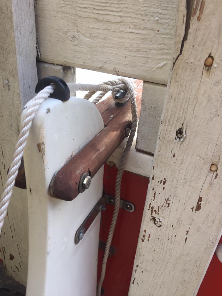

Here are some pictures. I have a fairlead on the top of the rudder and a horn cleat on the tiller. Used some old braid attached to bungie cord with a Heaving knot (http://www.animatedknots.com/heavingline/index.php?Categ=boating&LogoImage=LogoGrog.png&Website=www.animatedknots.com#ScrollPoint). Bungie end is attached to the bottom of lower rudder blade, the other end attached to the top of the lower rudder blade.
Once I have the boat in the water I push the lower blade down, and pull the cord tight so there is pressure on the bungie, then tie the line off on the horn cleat. If I hit something it will pop up. To reset push it back down :)

Postby GreenLake » Thu Sep 15, 2016 1:05 pm
Nice pictures. They give a good view of your design.
I like the use of the bungee cord to provide a measure of "give" in the system in the event of a grounding. (And it pulls the rudder back into position after it got deflected, e.g. due to ground contact, weeds or whatever).
In theory, one limitation of this kind of design is that the force on the rudder increases with something like the square of the speed as you sail faster (e.g. get on a plane). When you pre-stretch the bungee, you effectively set it at a certain (not very large) force. As you sail faster, the force on the rudder increases rapidly, until it matches the force on the bungee. At that point the rudder starts to deflect. Even if you pull the bungee a bit tighter, you postpone that point only by a little, because the force on the rudder rises so quickly with added speed.
That's where an auto-release cleat has an advantage - it requires much higher forces to release, more like the forces experienced only during grounding. (An auto-release cleat also stays released, so if you hit an oyster bed with your rudder, for example, unlike with a bungee you won't press the rudder down while you drag it across. In fact, for an alternate design, you might use a bungee as an uphaul instead to fully raise the rudder after the cleat releases).
With your motor you can push your boat up to hull speed (and then some) so presumably you checked the downhaul up to those speeds. So this theoretical drawback might only show itself if you got your DS on a plane.
Now one thing I don't like is the location of the forward attachment of your bungee. As it is, the flow over the top third of your rudder will be disturbed by the bungee, which adds drag and cuts down on the already not very great efficiency of the stock rudder design. I also can't see a reason why that location improves the function of the downhaul - so if I had to guess I'd assume this was chosen for symmetry? (For the uphaul, the location does increase the lever arm a bit and, being downstream of the rudder blade, it would appear to have less of an effect on the flow).
BTW, I thought the purpose of a heaving knot was to make the end of a line heavier for throwing it. There's something called a heaving line bend (https://en.wikipedia.org/wiki/Heaving_line_bend) that appears to be designed for joining ropes. That knot, or the double (triple) sheet bend, or the racking bend would seem to be appropriate for trying to connect a line to a bungee. The last of these would seem to be the most secure given the way bungee cord can be tricky to tie (see links in the Wikipedia article).

Postby DigitalMechanic » Thu Sep 15, 2016 2:08 pm
GreenLake wrote:Nice pictures. They give a good view of your design.
It may not be the best setup, but it has not failed me yet... with an emphasis on "yet". I have had the boat up to speed where I believe it starts to plane. Well, I am not sure if it was a partial lift or actually on plane, as I do not have a spinnaker and from what I hear that is the only way to get on a full plane. But something was definitely different. I have not been able to do it again since. Not sure what that perfect condition is, but the boat's attitude really changed when we got it, and everything happens so fast, lol. It feels like the boat is gliding through or on the water a bit, but the bottom of the boat is a quickly pounding on the surface of the water. It becomes more difficult to keep up with trim, and the tiller fights you pretty hard as well. If I thought for a second that I had a hand to spare I would have picked up my phone and turned on the GPS, lol. That may have gave some clues. Anyway, point is whether it was planning or not, the boat was going really fast, things were kind of violent, and the rudder stayed down the whole time. Maybe that was just luck? Maybe the bungee was allowing it to give way some and constantly pulling the blade back down? I would not know because I sure wasn't trying to take my hands off the sheet and the tiller, nor my eyes off the sails and the water to try and look, lol.
As for the motor, I hate the noise it makes... I try and keep it rev'd as low as possible and still make the boat move at a decent speed. The new motor is inherently much quieter (at nearly any speed), and I can run it much lower because of the extra HP which equals even lower volume. But again the sounds still racks my nerves so I have not really tried to see how fast it can push the boat. The good news is that we are able to have a conversation with it running now. Though I have not tried it, I do image the 4hp would make it go hull speed.
I will check those knots out as well. It is fun to learn new knots :)
When I go to the ramp a mile (or maybe less) down the road, I will be lazy and leave the rudder attached. If I go anywhere else I usually detach it and throw it in the cuddy (so it does not slide around). I get nervous that too much bounce/shake/jiggle from the roads (or flaws in the roads) will tear things up. My tiller handle does not appear to be in the beast shape either. One of my anxieties is that it will spontaneously break while on the water one day (if I ever figure out how to do the partial planing thing again, lol). But for trailering the tamer has to be on, so that probably provides unnecessary trauma to the tiller on trips further than down the road, so I remove it.
