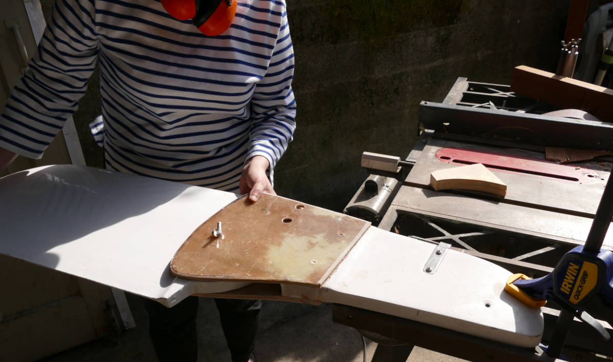

One shows the dry fitting. The cheeks are held in place by two screws that are countersunk and later covered with filler (wood dust and epoxy) and abandoned in place. They serve to fixate and also help in clamping when the cheeks are finally glued onto the main rudder head.
In the actual assembly there will be a large washer under the wing nut. The opposite side is just the typical carriage bolt head and doesn't get a washer.
Dry fitting everything

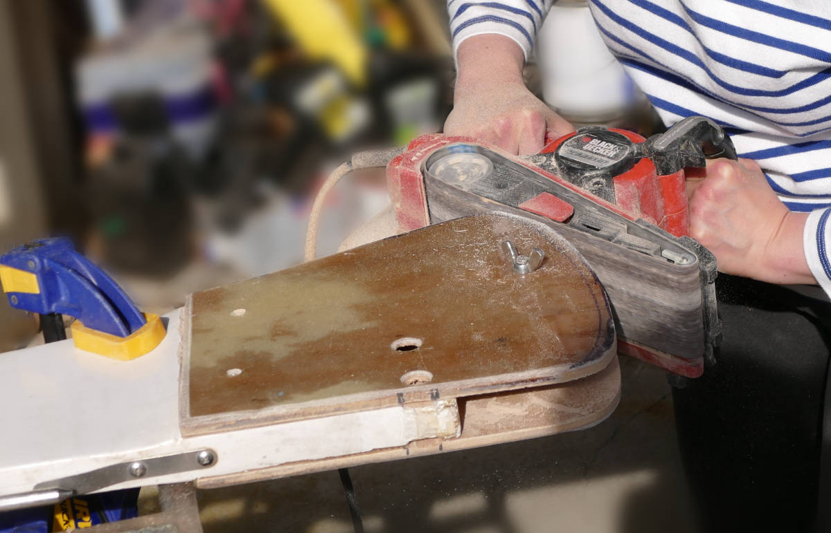

The other one shows the cheeks being sanded into final shape after rough cutting from the blanks. If you look carefully, you can see the beefed up outer layer of glass laminate (and the thinner, inner one). In order to strengthen the cheeks I opted to have the bracket for the lower pintle go into a slot between rudder head and the new cheeks, limiting the cut out to two holes that are large enough for the socket wrench for the through bolt. I was a bit concerned that I might accidentally fill that channel with epoxy, thus preventing the bracket to go in, but in the end, that part worked fine.
Sanding the final shape
Following this stage, not shown, I added another layer of cloth and a lot of filler to make a smooth transition between the part shown painted in white and the new cheeks. Both at the sides and the top. Ultimately followed by a layer of paint (Pettit EasyPoxy).
