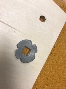

After experimenting a bit with my router and a scrap piece of the 1/4" BB ply, I found that even with a minimal depression cut into the wood, the prongs of the torque washer extended through the other side once tapped in. So I tried simply tapping it into the surface of the ply without any depression, and the photo shows the result.
I suppose I could try glassing over that, but I am also wondering if I need that torque washer at all. Would a simple square hole, carefully drilled and filed through one of the cheeks (ply + 2 layers of glass on each side) be sufficient?
Greenlake, did you embed a squared off washer of some sort or just go with the square hole idea?

tc53 wrote:I am planning to use a 3/8" SS carriage bolt as my blade pivot bolt, and as part of that plan, I am hoping to glass in a 3/8" torque washer to hold the head of that bolt.
I am using a carriage bolt as well. I simply cut a square hole into the plywood and sealed it well with epoxy. The only torque this hole needs to withstand is the torque from (occasionally) tightening the wing nut.
This is different from the DS1 Centerboard, where the square hole is used to lift the board, which can take quite a bit of force on a long lever. That lever operated rather more frequently (and the friction to hold the CB in place may be partially on the mechanism, so that the square hole sees the torque from holding the CB in place. All factors that do not apply to the rudder.
That said, if you'd like to reinforce the cheek with a torque nut, why not. (I would "hide" it with glass/fairing compound a bit. You could also cut a depression, but then, as you noticed, you'd have to trim the prongs - nothing wrong with that, incidentally).
Question about the material. That nut does not look like it's stainless. That would concern me, as I have sailed in salt water.

GreenLake wrote:Question about the material. That nut does not look like it's stainless. That would concern me, as I have sailed in salt water.
You're right, it is not stainless. I looked far and wide, online and in physical stores, and have not been able to find a SS torque washer. In the end, I picked up a few from Home Depot in "Rust Defender Grey," which they claim has "2X the corrosion resistance as hot dipped galvanized." I am hesitant about that too. Though I am strictly sailing in fresh water these days, who knows what the future holds?
I think I will go with the simpler "square hole method." Did you drill and file your square hole prior to glassing or after?
