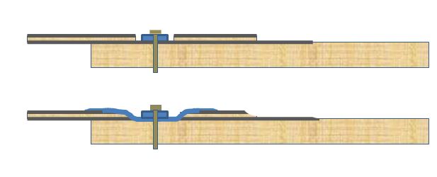

I've had something bump into my boat, hitting the rudder against the hull when fully deflected. Most likely at the dock. Details as to when and how are a bit murky, but it could have been the "swim step" on the transom of some motorboat; when I got back from parking the trailer, they were tied down very closely stern to stern at the dock and my newbie crew was fending them off. When coming out the the water one set of pintles had lost its screws on one side, and later inspection found the part bent. Either happened then, or unnoticed during the last sail in the previous season.
Either way, the bracket for the pintles, which should be a nice U shape, had a bit of an "S" in one of the flanges. That definitely looks like shock load, not stress from sailing with it.
In the area between the lower pintle and the bottom of the rudder head there's only about 1" wide glue joint between core plywood and what I call the "cheeks", the two plates between which the rudder head pivots. That joint had cracked with the blow. I decided that the current design had held up well enough to sailing loads, so I just dried everything, re-glued the crack and then changed the 3/4" wood screws that held the pintle to #10 machine screws (through bolted).
My thoughts on how I would improve the design if I rebuilt it from scratch would be to lower the rudder head a fraction of an inch where it forms the stop for forward end of the rudder blade (and to remove an equivalent amount on the blade end). That would increase the area along which head and "cheeks" are glued. Further, I would redo the grooves (channels) that I had to cut for the brackets that hold the pintles. These don't span more than 1", hence the need to have a narrow spot there. Instead of just taking material out of the cheeks, I would make a deeper / wider trench and line it with fiberglass, extended smoothly all the way around to the top of the "cheeks". That way, there would be a continuous load-bearing skin, even if depressed.
I'm not a mechanical engineer, but that approach promises to be ultimately stronger to me.
The sketch is very schematic, and I might ultimately make the inner part of the new glass (blue) a bit thicker than shown.
For now, based on sailing experience so far, it's not needed for the conditions I typically sail in.
