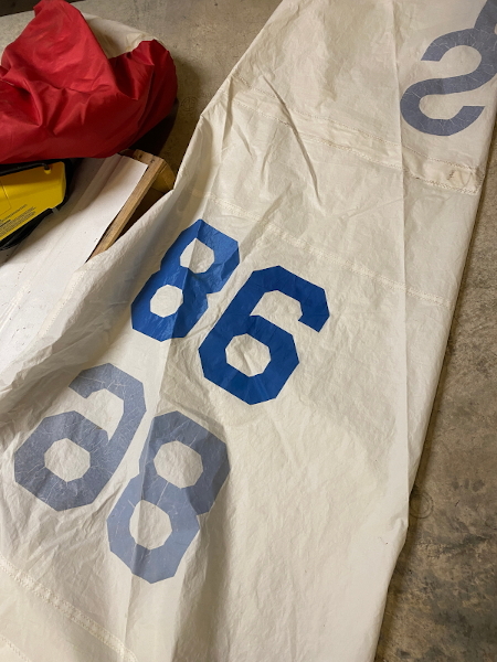

Postby cygtoad » Thu Sep 07, 2023 11:45 pm
OK so a little more info. First I pulled out the main looking for a hull number, as there isn't a reliable number on the boat. If the sail is correct, I have hull number 86. Given the characteristics of the the boat, that could be right, assuming the sails weren't purchased used. I makes more sense than the 2 on the transom. Still, a pretty early boat if it is 86.
