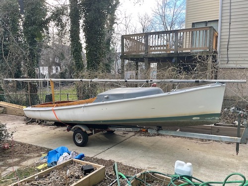

On to the next problem. The rub rail on this boat has deteriorated beyond repair. I was able to pull it off with my hands. It doesn't look like anything on the D&R marine website. I'll try and get a picture. Are there any known alternatives to the D&R products? I'm not opposed to spending the money on the rub rail system they sell eventually, but I'd like to get sailing sooner rather than later and my wife's patience with boat purchases has worn thin after preparing the big boat for my cruise this winter. I suspect the answer is, as always, just get the right thing but it can't hurt to ask.
I should probably show you all the boat at this point. Here she is on the day I picked her up from the Chesapeake Bay Maritime Museum, and in my driveway after I got her home. It's raining today but I'll get some more photos once it clears up. She needs paint (not sure what they were thinking with the gray gelcoat) but the seats, coamings etc. are in great shape. She has most of her original hardware except where a few bits have been replaced with what appears to galvanized steel (ugh). She is old enough to have been built without a motor well but someone added one and did a crap job of it so that's on the list for replacement.

Rubrails are not cheap. But they are amazingly sturdy. I recently had a keelboat bang into my stern quarter and you can't see a thing at the point of impact on the rubrail, even though the rudder broke from the boat being pushed sideways.
The original design uses some PVC structure over which the actual rail part is placed. I've never seen the inside, so I can't tell you whether it's continuous or discrete clips or whatever.
On a DS1 the hull deck joint should end up as basically a flat strip of laminate. So anything that works to cap this (and is strong enough for the job) should be a candidate. It might be that what DR Marine has on offer is your best bet - but I haven't researched this.
If it's a matter of "financing" the purchase, it may be something that you can put off for a season or two.
PS: is your hull-deck joint damaged? or do you think it's that internal structure that has given out?
Re: Daysailer I number 63
Postby GreenLake » Thu Mar 23, 2023 6:33 pm
Just looked up the website. Looks like the rigid underrail comes in 7' sections. If your issue is at the stern or near the transom, you may be able to open from the back, and perhaps do a replacement of a small section. But I've never worked with this and don't know what issues you'd encounter.
The RR may also have become too stiff to be worked with. Mine is really stiff, but otherwise still strong, hence no experience yet in replacing it.
I poked around a bit on other sites, but I don't see anything comparable to what the DS 1 uses.
