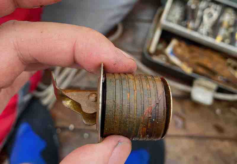

New here, grateful for this amazing resource. Our boat lives in a yard on a barrier island (NC) far from my St. Louis home, only see it for a couple weeks every 2 years, and about to return next weekend and need to get parts before driving out. Foam is totally waterlogged and plugs are worn out, so planning to replace plugs and hopefully install inspection ports to replace the foam. So...
Am I correct in guessing that the drain plugs for the seats/benches/flotation tanks are 3/4 inch? Hard to tell from my pics but someone had suggested threaded plumbing plugs from Home Depot, which I picked up (both pvc and brass--the idea seems fishy to me but can't source stock parts). But maybe they're 1 inch? First pic

The "stock parts" for my vintage DS are - wait for it - cork plugs. Those don't really do anything.
Basically anything that produces a decent seal would be fine. Now, these original DS1 seats are like closed tanks. So air in them pressurizes when it gets hot. (I could hear air escape past the corks when anyone sat down). I was worried enough about that that I used something that blocks most of the hole but isn't air tight. The idea is that, yes, the tank may fill (slowly) but there's no risk of it popping a seam in the sun.
I just went and took a photo with a tape measure as reference. The cap I put on is 1" diameter, but I think it's a bit less on the inside, but my guess would be 7/8" rather than 3/4". But I didn't try to prize off the cap.
For the deck plates, I've know "Sea Dog" makes some, and I've used parts from them before (can't swear to deck plates). (Where I try to be selective is which online or local outlet I get them from. Just the idea to keep as many marine or even DS specific suppliers afloat.)
I found that I could not get any exact replacements for the drain plug in the transom. I ended up getting a range of sizes of rubber plugs and sanded one of them to fit with the original handle. That one I could measure (roughly with a tape measure) and it looks like 7/8".

Many thanks, GreenLake--this is very helpful. Corks--ha! Looks like I'll want to wait until I'm there and see what I've got. I might try to carve something out of an old crab pot buoy or something, but the air expansion issue I'd not thought about. Gets really hot there and makes sense to not want it totally airtight, so it shouldn't be too hard to fashion something good enough, and with that in mind maybe my old plugs are good enough.

On my DS1 I used 1" diameter flip-lock plugs from West Marine. By spinning the handle,you can compress the plug and alter the diameter a bit to get a good fit.
Incidentally, when my centerboard fell off (!) I was able to compress the forward bulkhead plug enough to stop the hole in the CB locker where the lever had been. I think I'll try adding lock washers next time.

Those flip lock plugs are great, if the transom hole accommodates them. I'm not sure that all model years had that drain as original equipment and/or whether all model years had the same diameter. Mine is nearly sixty years old, and I wouldn't be surprised if there had been a small shift in standard diameter for these transom drains. Hard to know for sure, but if the plug fits, they are great.
