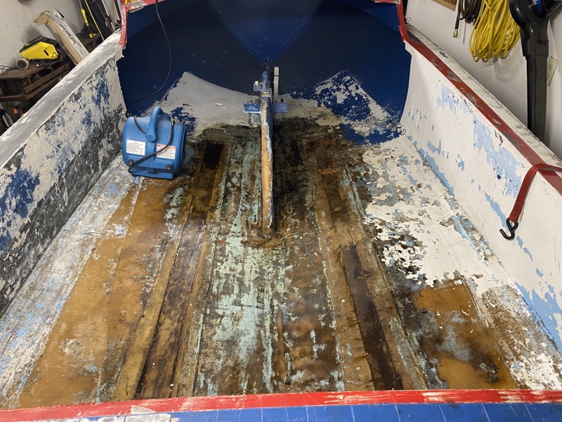

2 bottles of Goo Gone, a wire brush, two rolls of paper towels, and a scrapper.
Not perfect, but good enough to be able to sand it in next phase without fouling the sandpaper.
I also did a first stripping (Citistrip) of the port side gunwale. From old paint I can see where the seats must have been mounted. Anyone have any idea of the depth of the seats? I did a little research recently and I am considering using Iroko wood (African Teak) for the replacement wood for the seats and coamings. It is a quarter the price of teak and it seems I can get it in much wider board widths. Farmed teak is pretty stingy on width as the trees get harvested young. I know the original's were probably mahogany per the forum, but Iroko might be better option rot wise.
looking aft
towards the bow
