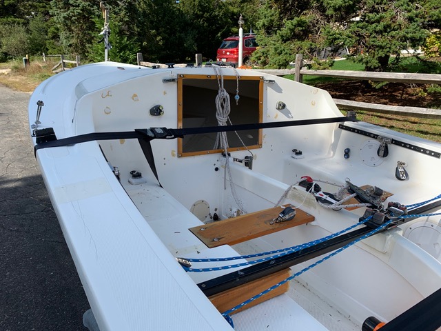

Bulkhead back in place, the opening is large enough to crawl into and easily set the mast heel, no sharp edges. I'm partial but I think is is so much better than a store bought hatch.
Next up, I need to work on the seats. My thought is to have the section in front of the thwart removable with a bin down below for the crew to stash a small cooler. In back of that the seats will be strip planked the same as the bulkhead so that they will be buoyancy tanks. I'm thinking of putting in a small Elvestron bailer (self bailer) but I don't like where they are placed on the modern boats. They are under foot when you are setting up for downwind and setting the spinnaker. I'm thinking either to put it as far back in the cockpit as I can, to replace the drain plug or forward under the thwart. It may drain better under the thwart but it will be easy for the skipper to control if it is in back.
