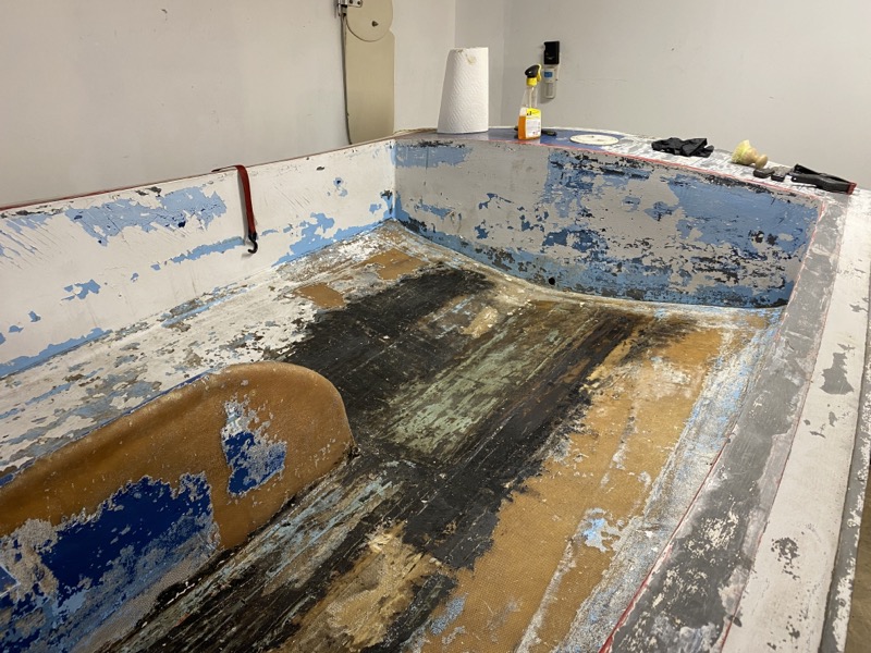

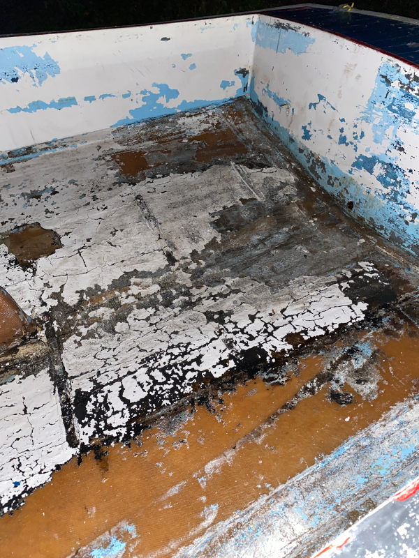

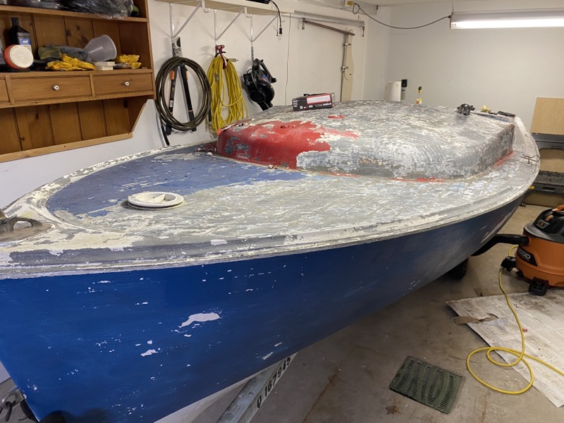

Update on progress:
Moved the boat indoors and suspended the stern on pallets and bags of wood pellets to take the load off of the deformed spots in the hull. I can see the boat had stringers at one time but they were removed. I can only guess why.
The boat leaks from the aft end of the centerboard trunk despite prior efforts to remedy the issue; glob of epoxy on the underside, silicone, Bondo, and worst of all an eighth of an inch of tar over the inner hull. I think the continued flexing from the lack of stringers has been causing unresolvable leaks.
Anyway the solution is to strip back to bare glass and address the lack of rigidity with some new glass and coring. For now heat gun and scraping of paint and tar is the task. I have removed about 3 lbs of tar already. Next is likely Goo Gone and acetone prior to sanding. I will also probably use Citri Strip for the remaining paint.
I will post some pics once I get them resized.

Postby cygtoad » Mon Nov 06, 2023 12:23 pm
Inner hull

Re: Mystery - What do I have
Postby cygtoad » Mon Nov 06, 2023 12:27 pm
Stern
Postby cygtoad » Mon Nov 06, 2023 12:28 pm
Bow

Postby tomodda » Mon Nov 06, 2023 2:15 pm
That looks like a job and a half, good on you for keeping at it! For what it's worth, the early DS hulls do oilcan, it's nearly inevitable. It's worst just a bit forward of the Centerboard, so I'm a but surprised that the CB to hull joint is leaking. Once you get the tar/gunk off, I'd lay in a nice radiused bed of epoxy, put a layer or preferably two of fiberglass bias tape on it, soaking in a few coats of epoxy. Look at any website on stitch-and-glue plywood boat construction for how to do it. If you can finagle it, you may want to put a layer of fiberglass on the outside of the CB-Hull joint as well. It not as if you have smooth laminar flow there, so you won't be slowing your hull down if you put in some glass on the outside of that joint. I'll let GL chime in here....
Some personal opinions, not facts: I do like Citri-strip paint remover a lot. What you can't get off with the stripper, you can sand off. All good. For your next step - painting - I highly recommend Kirby Paints hi-build marine topside paint. Doesn't need primer, and covers up a lot of sins. If you are dry-sailing (trailer), then you can use same topsides paint on the bottom, it's good stuff. Being obsessive compulsive, I sanded the bottom down to some ridiculous grit (1200?), but 400 would have been more than enough, thanks to the properties of the high-build paint. I say (write) this because those are the grits that I sanded the bottom and topsides (respectively) to, and I can't tell the difference after painting with Kirby's topside. On the other hand, I think that one place where you do want bottom-type paint is in the bilges, since they tend to accumulate water and you don't want to grow a swamp in there while boat is on the trailer. I used up about a pint of Petit Bottom Paint (in grey, for what it's worth).
Postby GreenLake » Mon Nov 06, 2023 7:09 pm
At some point the DS1s got a drain at the back edge of the CB trunk. Once you've removed all the gunk you should be able to confirm whether you are dealing with a hole from such a fitting or a cracked trunk.
If the latter, I would grind the outer hull a bit to allow a layer of heavy tape over the outer edge of the cracked while not adding any more overall thickness. If the existing laminate is cracked through, you should feel free to grind away inside and outside as long as you leave just enough to hold the CB trunk in place and retain a solid substrate onto which to lay up the fresh laminate.
What Tom means with the pointer to "stitch and glue" is that there the wood is the substrate and when laminating corners you need to fillet then to ensure a smooth radius. And the usual technique includes using tape of decreasing widths to avoid hard spots (on the inside). On the outside, if you add laminate you would fill an area you ground off, so the surface would end up level and no worries about hard spots. But you'll need to fair.
On the inside of the bilge I 've gone back to gelcoat. It's more durable than paint wrt moisture or walking on it. As long as you test the amount of catalyst needed, apply it with sufficient thickness and get the kind that cures in air it's not complicated. I have an older post on this somewhere. I used a spreader to apply and liked that the result was a bit structured. That worked well with the surface being already a bit uneven from tabbed CB trunk to stringers.
You can tint gelcoat with universal tints if you don't go overboard. A medium gray should BA achievable and would make an attractive bilge color.
