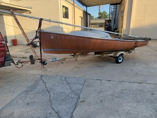

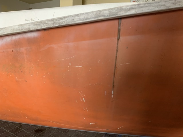

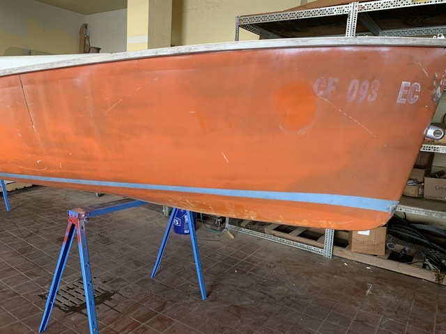

Got a chance to power wash the boat today and get it onto some horses for fiber glass repair and paint. A few issues here and there but nothing too crazy. I am going to redo the top coat now as well as the previous cost is coming off too easily.
As far as rigging is concerned, is there a parts diagram for these boats? Something I can look at to verify the inventory of what I have on hand? Also, the ropes are toast, is there a reference for how many feet and what diameters I will need? The online owners manual does not reference this.
Here are some pictures, next step is to start sanding everything down.

  1. Rudder: we discussed that earlier. Source a used one, or build your own

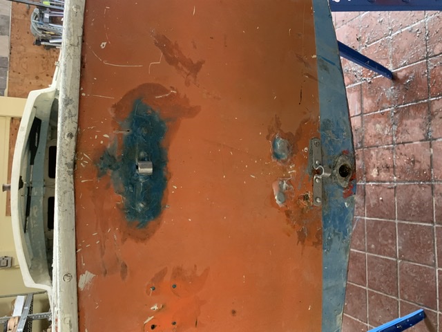

  2. Transom: we are missing a critical picture from you: the inside of your transom. It appears there were some repairs done to the upper gudgeon. The "backing plate" for these is a strip of wood glassed on the inside. Now's the time to determine whether that wood is rotted and to replace it, before you proceed with painting the interior.
  3. Coamings and carlins: the early DS1s have wooden coamings attached to wooden carlins under the side decks. The gap between deck and seat seems to have been filled (for additional flotation). That is usually an improvement, although it necessitates finding replacement stowage areas (like for your paddle). You do want to restore the coamings. Either full height, or just flush to the deck level. They add a bit of structural support to the boat, to the point where the class association doesn't allow anyone to race the boat without them. Check the gallery for pictures of other boats like yours (similar cockpit layout/age).
  4. Thwarts: the boat is supposed to have two wooden "thwarts" that connect the seats to the CB trunk. You can see the place where the seat molding have room to attach them. On the CB side, they are usually held by L brackets glued/glassed to the CB trunk. They give needed stability to the boat. You may need to measure them to your boat, because of tolerances, but if you do so, don't support the boat only on the keel, as that will "open" it. Material, like the coaming used to be mahogany, but you can see what you can afford and check on google which species are good for marine use. (I epoxy-sealed mine as described on the SystemThree site, or also in several posts here).
  5. Mast: your mast is keel stepped with a mast-jack (the fat threaded rod with circular nut). You are supposed to drop the mast in, attach the stays, and then raise the mast by turning the nut until there's suitable tension in the rig - about when you can start to strum a note on one of the shrouds (aka side stays).

1) Yes, I am following up tomorrow with previous owner to see the status of a rudder. If needed I will build one no problem.
2) I do have a picture but the lighting is bad. There is no wood on the inside of the transom opposite where the rudder mounts. Just fiberglass and what seems to be some sort of silicone repair.
3) Yes my plan is to pull the existing foam and replace with something better than won't flake away (pool noodles?) and rebuild the wood sides. I will likely go deck height.
4) OK perfect, I was curious about how to attach them and planned on making some. Is the way I have the boat sitting on horses causing an issue with this gap? Should I move the boat forward or perhaps just support the boat around the middle using shims.
5) Ok, I noticed this assembly is pretty wobbly and loose. Should it be more "fixed?"

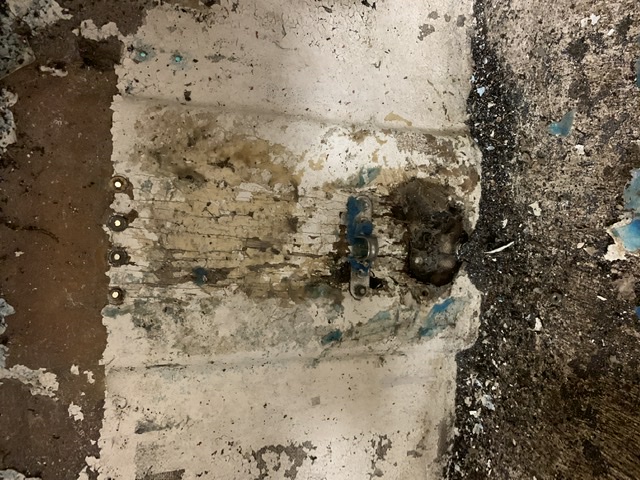

Ok after further inspection, I may have the transom support? Here is a photo.

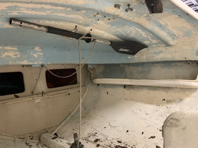

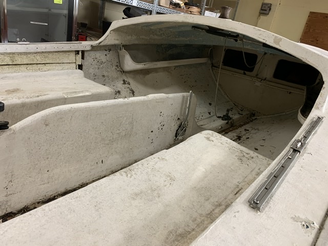

Here is the rest of the hardware currently on the boat. I will have mast photos later once I get the other set of sails.

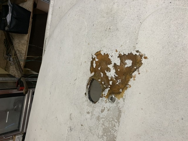

the rigging hardware you show is not complete, and some is a bit unusual.
  1. Stemhead fitting(bow): This looks like it has a way to adjust the forestay tension with some hardware that is underneath the deck (because of that wire that goes down). In principle, it's a nifty feature to have, but you need to figure out how it was rigged and lead a line back (perhaps that was what that cleat on the side of the CB trunk was used for??
  2. The transom was rigged for a traveler (the two sheaves embedded). You can fit a line there that makes a triangle (connected underneath) with a block (pulley) at the apex through which the mainsheet runs. Your boat had cleats below the rear deck to adjust the traveler --- there's also a chance that the boat used a split main sheet, but you don't have to replicate this -- you may read up on what it is, though.
  3. Your mainsheet swivel and cleat on the CB trunk looks ancient. See whether you like how it feels. I'm still using my original, other people have upgraded theirs.
  4. Your mainsheet might be rigged this way: from the swivel, up to a block on the mid boom, from there to a block at the back of the boom, down to the block on the traveler, back up and tied off on a becket that's part of the block on the back end of the boom. That would be a typical setup. You should be able to find pictures.
  5. Your transom support shows exposed wood. No good; likely has rot. Nick shows how to replace that with solid fiberglass, but I think that's not necessary. Just fit a piece of outdoor/marine plywood and seal it in epoxy on all 6 sides before glassing it in. (You will need to carefully seal any holes you drill, to maintain perfect seal). That should do it (and it's lighter than a plate of fiberglass - weight at the stern is to be avoided almost as assiduously as weight at the top of the mast).
  6. I have no idea what the U shaped plate on the middle of the foredeck is supposed to be. Any legible writing on it?
  7. The mast jack is indeed "wobbly" when not in use. Not an issue. Do grease it well before using, but not too much or it will get black grease on any gear you stow. Maybe some of the more "waxy" lubricants?
  8. The eye strap on the transom may have been put there for hiking straps.
  9. No idea what the two cheek blocks at the mast base might have been used for, esp. as there's no visible cleat anywhere that any lines going through them might have been cleated to
  10. No idea what T-shaped key fit into the deck fitting. Not a part I've seen before
  11. You appear to have a set of spinnaker blocks on the stern (aft of the stern cleats. Looks like they are snatch blocks (i.e. you don't need to thread the sheet through when rigging, but just close the block around it - evidence of rather sophisticated rigging on your boat at one time - you apparently do not have a spinnaker sail - don't discount the idea of getting and rigging one eventually.
  12. I'm still not seeing any cleats for the jib sheets. Perhaps there's a set of block/cleat combinations that were mounted directly on the jib tracks. Or you may simply use a block there and cleat on the CB trunk like in the image below.
The mystery hardware directly underneath the cuddy deck I have no idea about. And we've not seen what cleats / blocks / sheaves are on your mast and boom. If I missed something let me know, the images are so large that I can't see them in their entirety without a lot of scrolling, so easy to miss something.

1) Yes in photo 9 you can see a rope coming through a hole in the front wall. It is attached to that wire. There is also a cleat under neath that I believe it attaches to.
2) Ok perfect I understand
3) ok will add that to my test check list
4) Will post pictures of the boom I have as well. I believe you are correct.
5) Ok I will verify. I am not sure if that is wood or exposed fiberglass (paint chipped during power washing) Noted either way.
6) Will inspect tomorrow
7) noted

Found out that top plate says RAY-O-VAC. Must be something to do with a battery or lighting system at one point.
Also found out the transom support had way more rot than before. Going to fix that tomorrow!

Postby GreenLake » Sun Jun 28, 2020 12:17 am
Ray-O-Vac: perhaps someone had a "search light" mounted on the foredeck.
